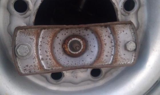

I ran into this back in the old days when I put a mag-hytec cover on, here is what I did... ... As in the pic, I put in two bolts about two inches long at the ends of the bracket . Instead of the bracket riding in the center of the rim hole, the added bolts go in two of the lug holes in the rim which moves the tire to rear. It gave me almost an inch of clearance between the tire and cover when loaded. Cranked it up tight, been that way for years.

I guided/pushed the spare all the way rearward (under the truck), while my wife cranked it up. When you crank it all the way up, the friction between the tire and bed will keep it in place.
