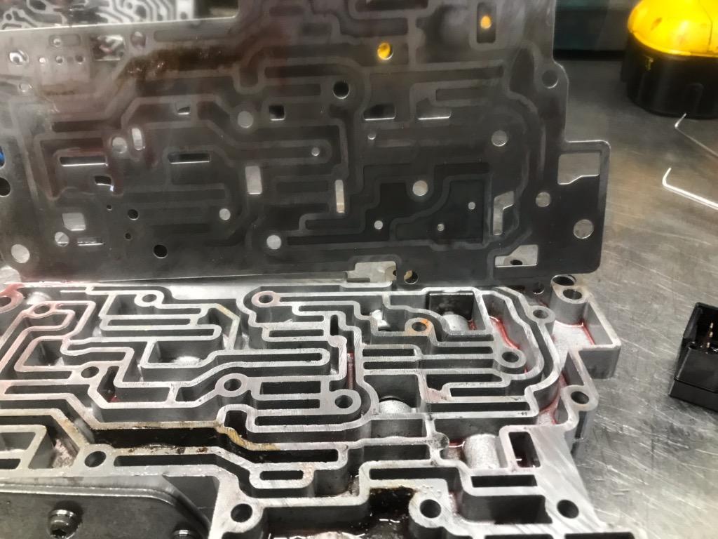

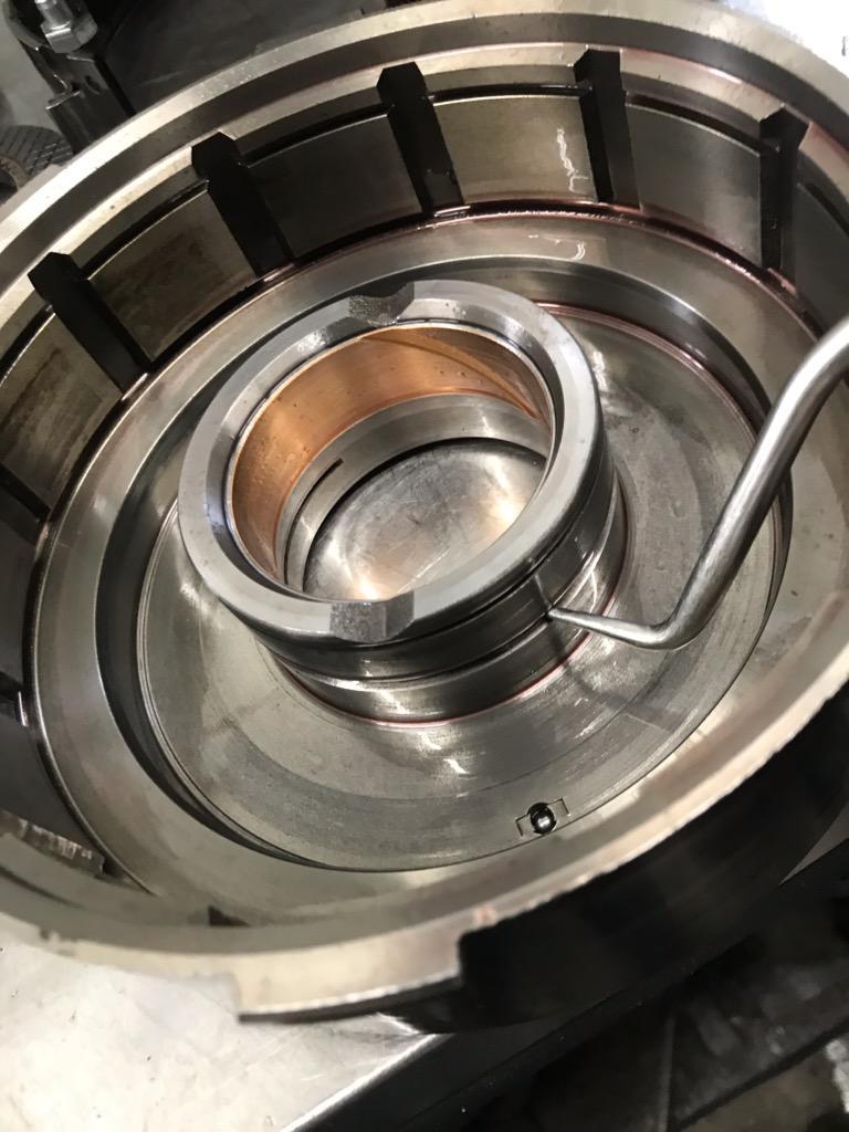

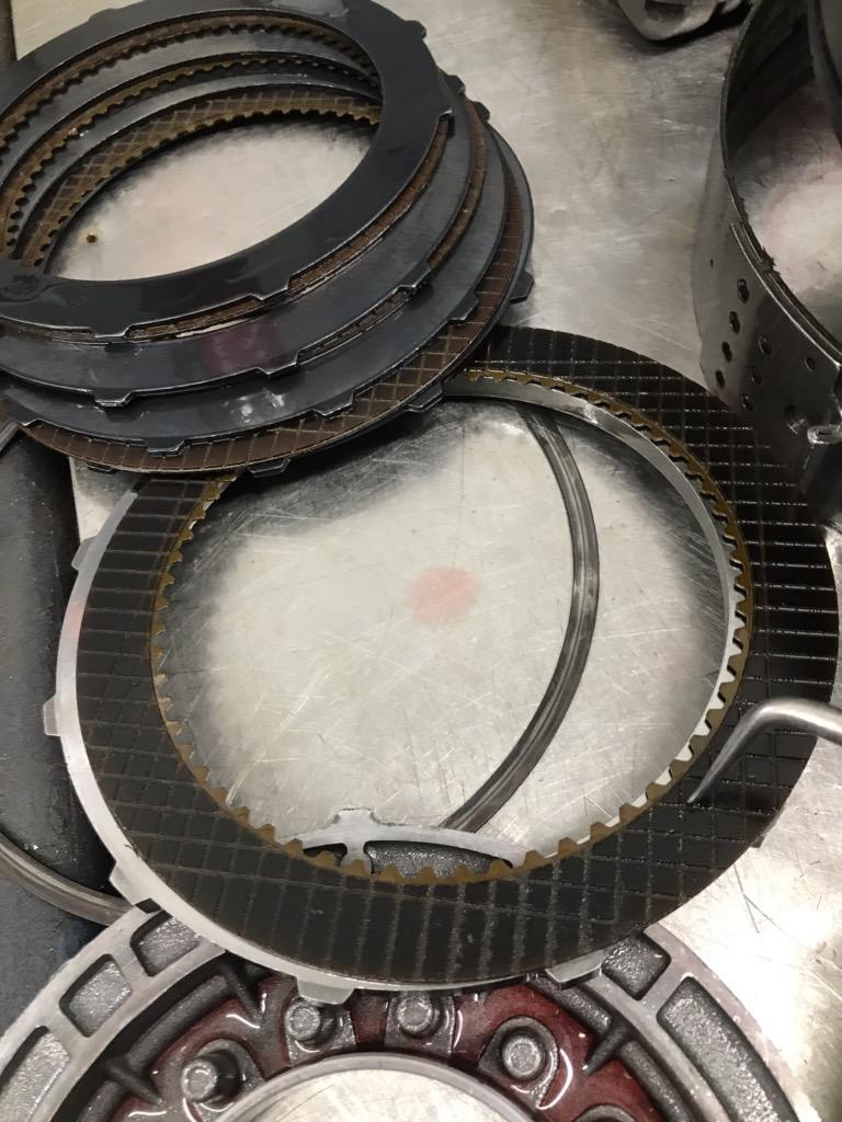

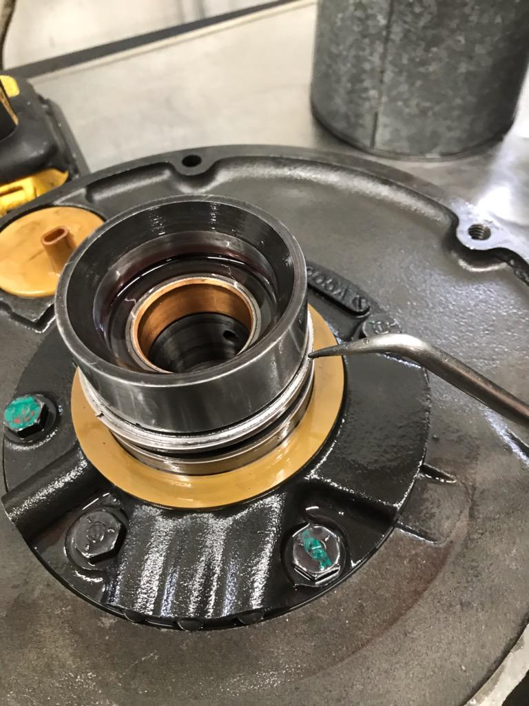

Here are some pics if the crappy work performed by monster transmission. Missing seal, improper install of a bushing, resulting in stator damage. Crap in valve body, poor clutch disks. This is the transmission I received back from a warranty claim. The transmission pan also had a leak, rust hole. So I will not recommend them. I paid for it go to them once. It took 3 months to get back. Then they wanted me to send it back, again, at my cost. No! I had to pay to have it pulled twice now. And it needs to be rebuilt again.very upset.
