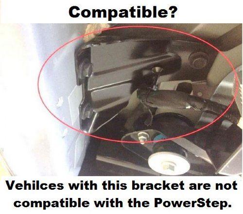

I wonder if this is the fix you speak of.. I found this pic on a website while looking for the electric amp steps. They said if your truck had this bracket, the steps won't fit. My 2014 doesn't have it nor my 2016.........Bob or Sag.......what is it??????

There is a bulletin on this from FCA. Mine goes in tomorrow for this repair and a whole host of other things. They weren't really detailed about it, but there is apparently some type of pad that gets installed in the mount between the cab and frame.
Please try to get more info on this when you go in. Lots of us have a clunk and would like it gone.
There is a bulletin on this from FCA. Mine goes in tomorrow [1/6/2015] for this repair and a whole host of other things. They weren't really detailed about it, but there is apparently some type of pad that gets installed in the mount between the cab and frame.
Any news? Pictures? TSB #?
I had this repair down the week before last. It's lessened the clunking noise, but has not completely eliminated it. I honestly haven't looked at what they did yet to see if it looks like the photo in this thread.
