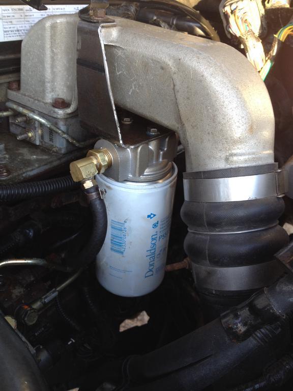

This is the bracket i made, with Donaldson P551313 between OEM filter and CP3.
