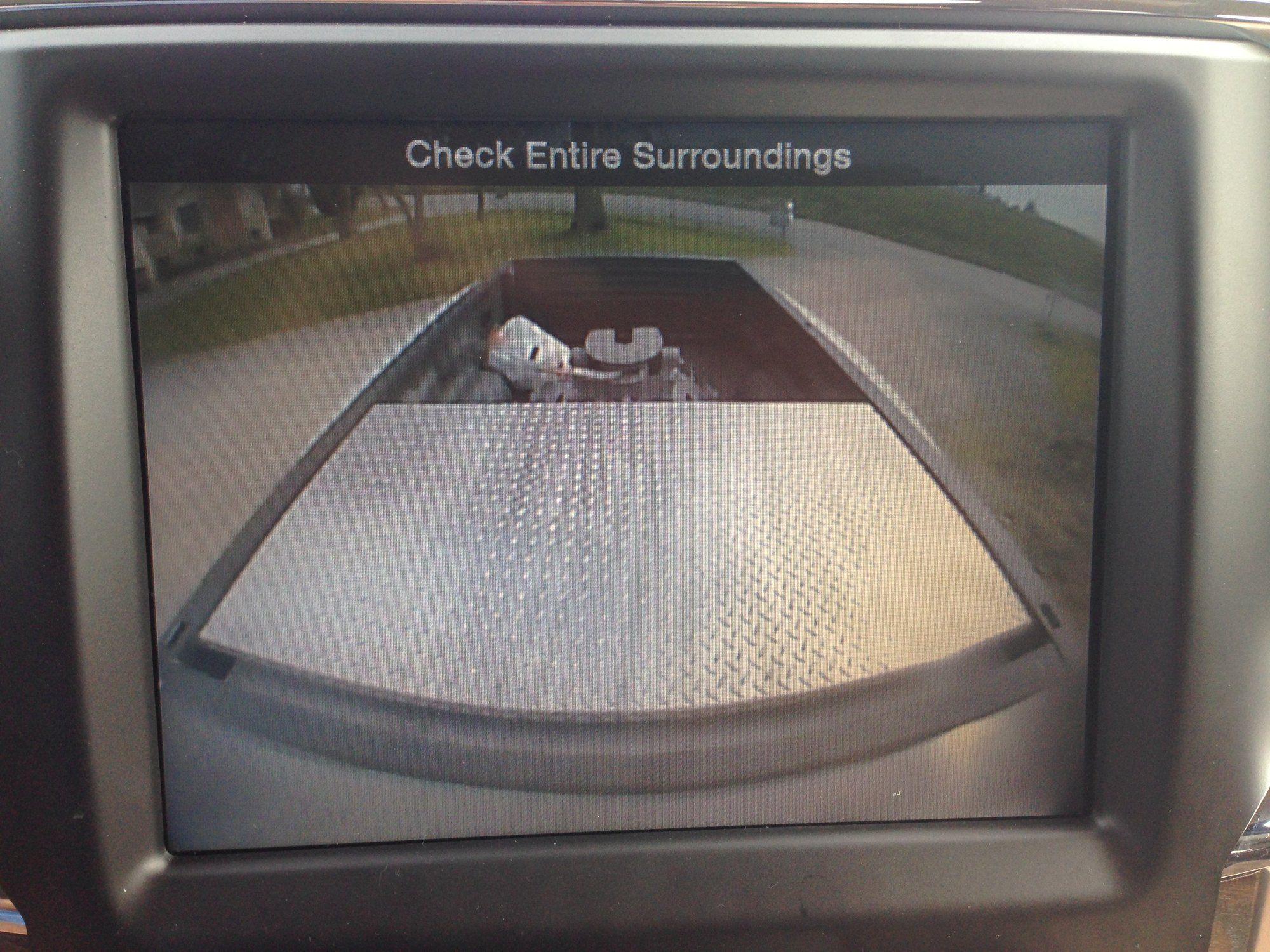

I have the factory cargo cam in the high mount brake light on my 2014 crew cab long box. I also have an L -shaped tidy tank/slip tank with a toolbox on top of it in the box of the truck. The toolbox/slip tank combo block the view so that I still cannot see my fifth wheel even with the cargo camera at the top of the cab.
I had the cargo cam on my 2015 and have it on this truck. I've not found it to be ideal for hooking up either a gooseneck or 5th wheel and still resort to the old fashioned 'jump in and out' method most often.
