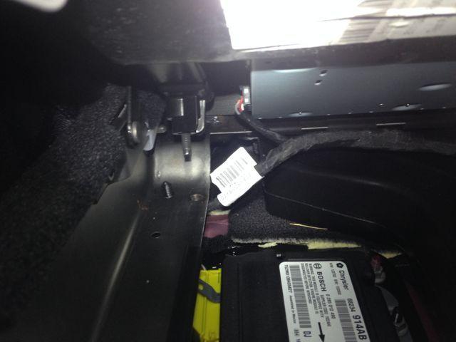

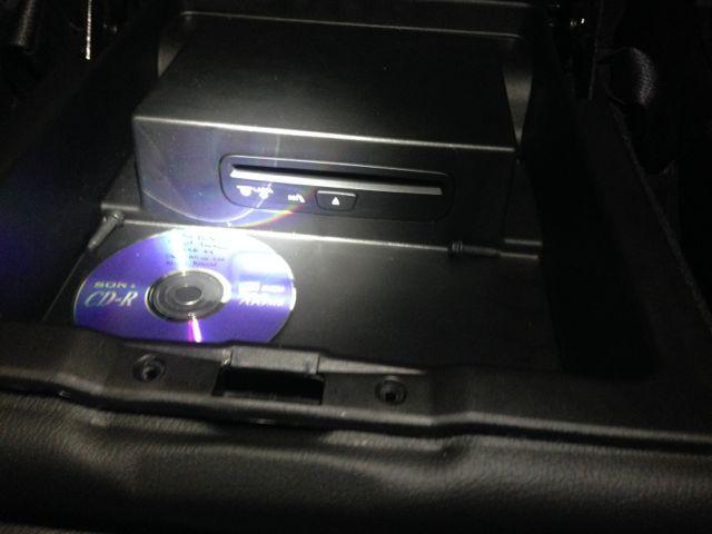

Here's what's under the lower portion of the console: I have the $120.00 CD player option (there's $120.00 that I'll never get back for an option that I'll never use!), and it's mounted inside the lower portion of the console, under the "seat". In the second photo you can see the wiring harness that runs to it - with the little bit of red wire showing where it plugs into the player. Does anyone happen to have a wiring diagram which shows which wire is the hot lead? That's gotta be a pretty "high current" lead given that it runs a CD player with a motor and a laser (Just checked it looks like fuse F67, 10 amp). If not I can find it with a lead voltmeter.
