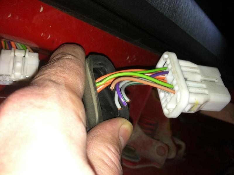

Had to do this to my truck last spring, rear driver side door. I thought I had some more pictures, but only found the one, not sure if it will help, but you see the broken wires, the wire starting to break, and there was a 6th one that was broken as well. Basically nothing on that door worked, no locks, speaker, dome light, window. I scabbed it together, which I'm paying for now as my dome light is not activated again, my butt connector splice lasted 6 months. Lesson I had to learn... again... to do things the right way the first time.
You can see both ends of the white connector in question. The black boot I'm holding in my had is pulled out of the door jam on the truck. Anyway, hope this helps,

Turns out that this was my problem! Glad I found it here before I ordered a new lock actuator assembly. I had 2 wires completely broken off - I did a quick solder job on the 2 and put it back together for now. Everything is working again! Hope it lasts for a bit - I'll start working on a plan to do a more permanent fix someday (when it happens again).
