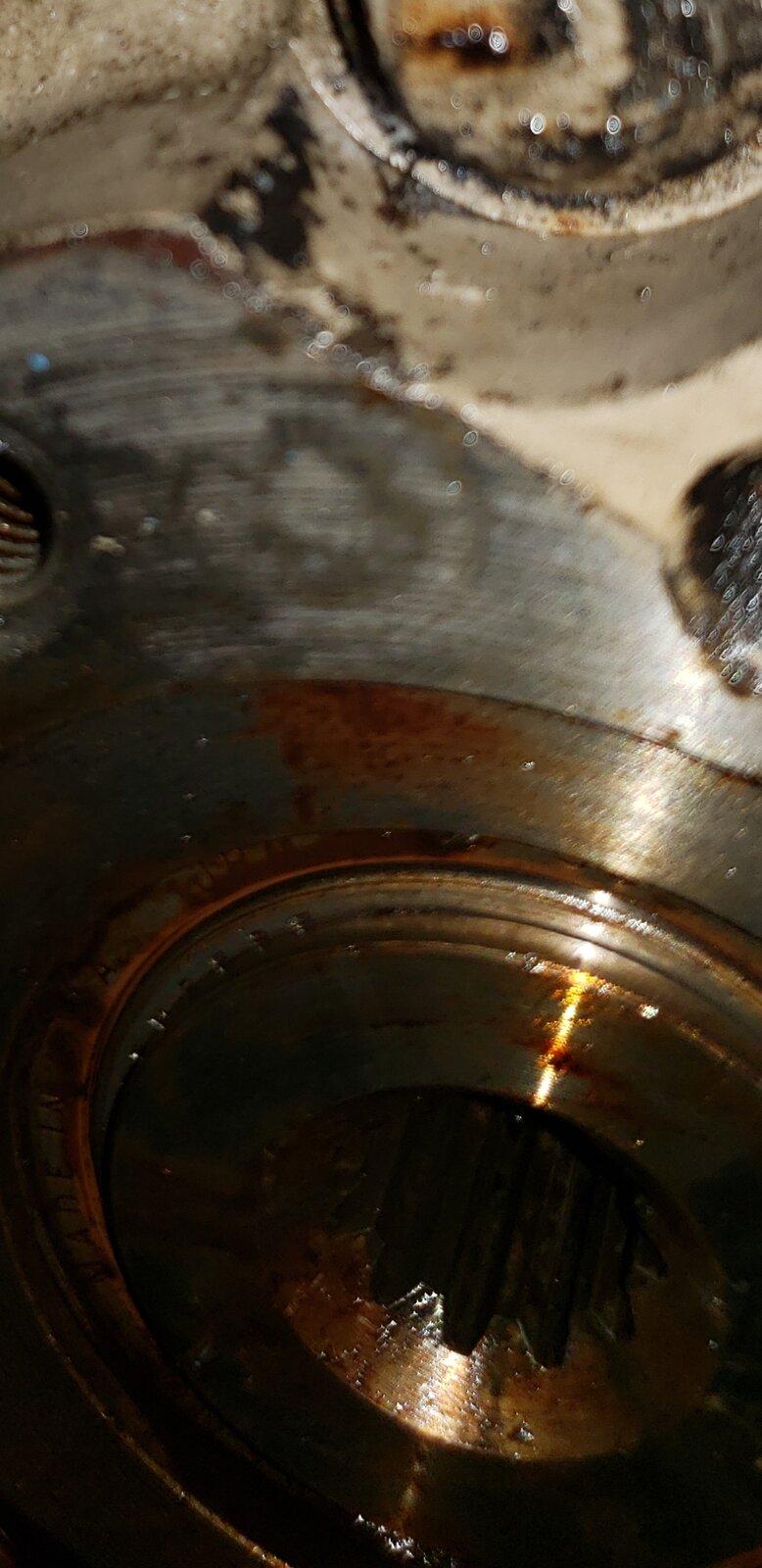

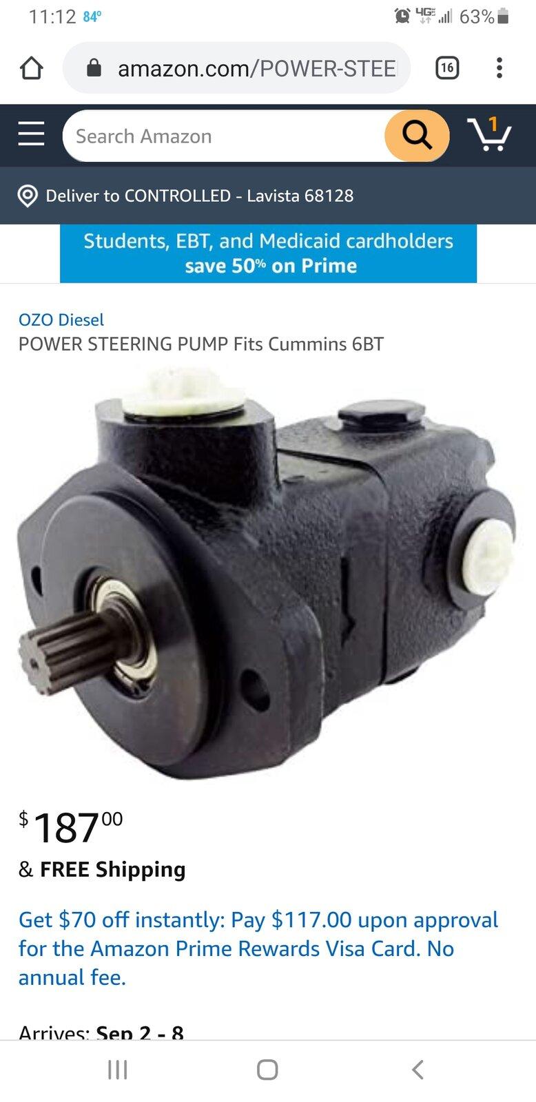

So I figured that I would replace the PS pump (probably should have just done that first). So I went to the parts store & looked at both a 1992 & a 1994 Ram PS pump. Neither appear to have the same shaft into the block as mine does.
I only included a 1994 model because this 6bt did come with a P-Pump even though its a earlier model year than the Rams that got them....
So I called the local Cummins parts place & they were absolutely no help at all... unfortunately (for me) the engine ID tag is missing in action & without that apparently you are dead to them.
Sorry for the novel.... looking for advice as this amazing converted pickup has turned into a driveway paperweight that is not drivable.

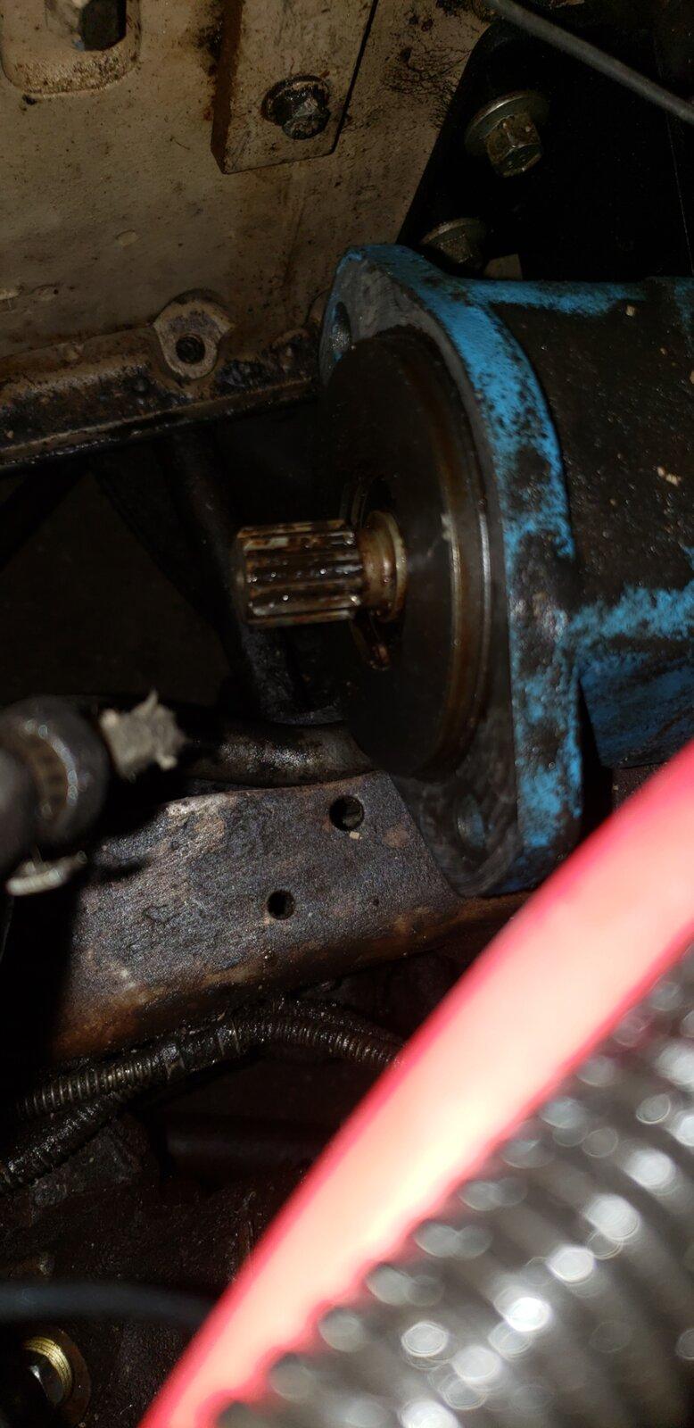

The ps pump on the truck now has only 2 bolts to the block & has more of a asterisks shape to it.
The ps pumps at O'Reillys & that i see online have more of a round shape with protruding slot that sticks out from it.

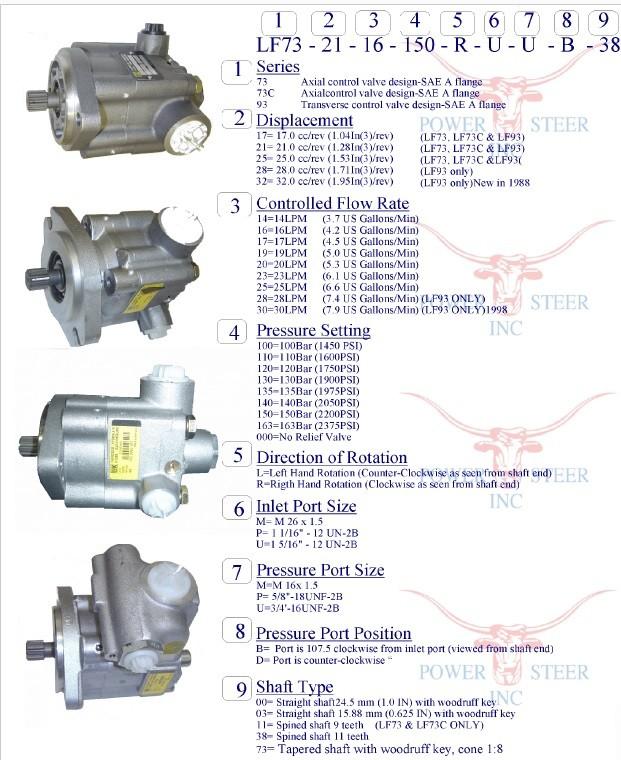

I looked into the HD pumps a few years ago. Our buses use the HD pumps and all the hoses except the supply hose from the reservoir are 3000psi hydraulic hoses. Here's a chart I found showing flows and pressures. Our OE pumps run 1450-1550 psi and 3.1-3.5 gpm. That's basically the specs on the smallest of the HD pumps.
