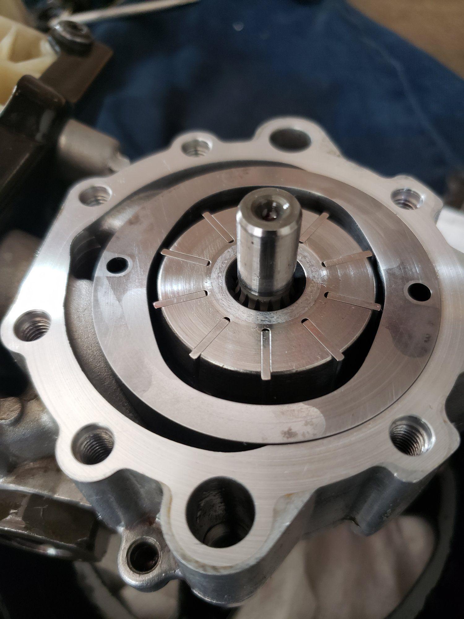

Well. Went to napa to grab a pump. Stupid chinese junk Bolt holes don't even line up. Tore this oem pump apart and everything is in great shape. Put back in and it's noisy as hell. Sounds like air and a lot of it. No bubbles though.

Replaced hydro boost . Didnt help much . Tore open pump Polished and cleaned internals. A lot quieter Ill give the air a chance to rise and see how she does.
Dare i say I think problem is solved. New booster and cleaned pump. Re bled. Works almost as good as it did before all this mess. Thanks for the tips.
Started with 1000. Moved to 1500. Then 2000. Then cleaned the hell out of it. I think it was a combo of things, but mostly the pump and booster.
