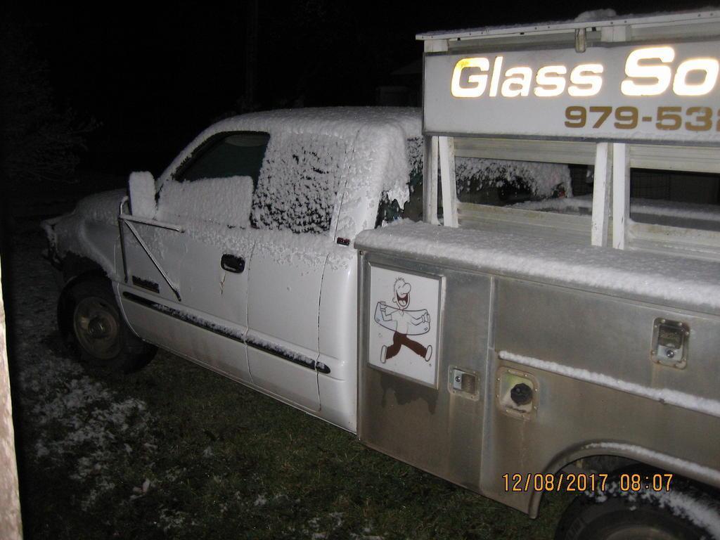

Woke up this morning to 33 degrees & 2" of snow- very unusual for SE Texas. Truck started fine on the grid heaters but, as I started off, the PS pump growled loudly whenever I moved the steering wheel or touched the brakes. I stopped at the end of the driveway, shut the engine off, & checked the PS fluid, which had foamed up & came out of the pump when I removed the cap. Not wanting to risk burning up the pump, I reparked the truck & drove another vehicle to work. Around 3pm it had warmed up into the low 50s. I checked the pump again & the fluid showed to be at the proper level. I started the truck and drove it around a bit & the steering & brakes worked normally with no complaint from the pump. Any idea why it acted up @ low temps? Does PS fluid get so thick that it won't flow @ low temps?
