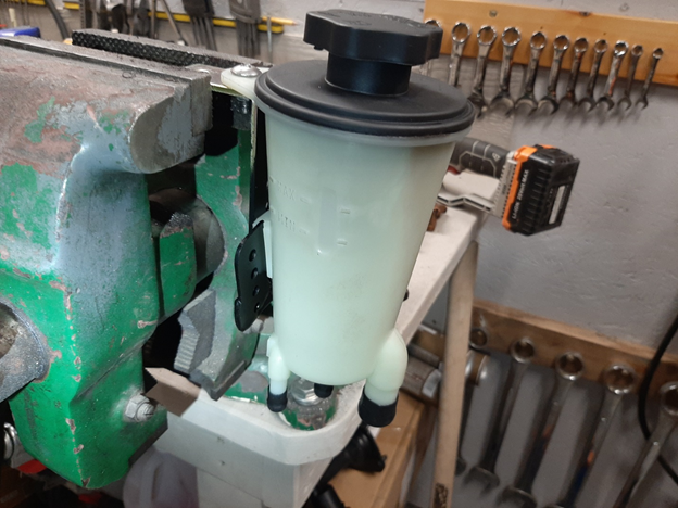

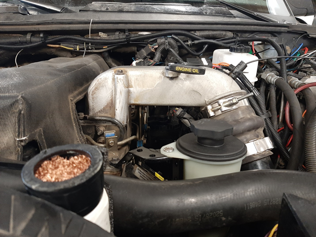

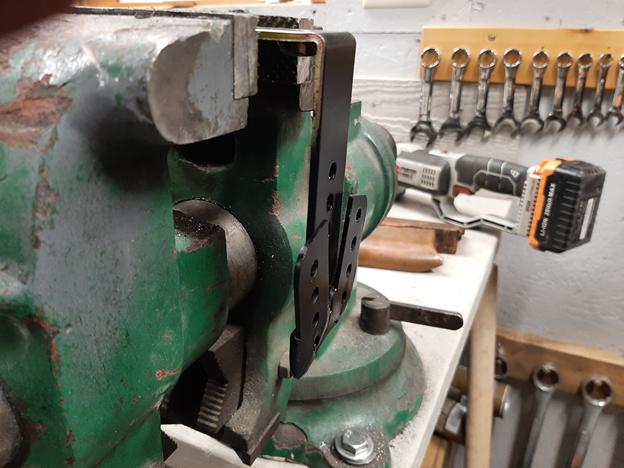

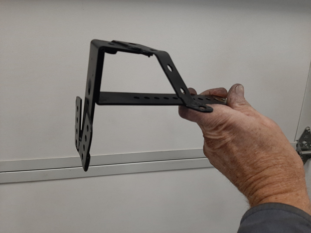

I started the project by finding the specific location for the new power steering reservoir, which was going to be right where the APPS assembly used to be. Then I built a mounting bracket for the reservoir (shown below). The first part of the bracket assembly is designed to let the weight of the reservoir and the contained fluid rest into the V slot.
In the photo above, note the welded nut where the tab on the top of the reservoir is screwed into the bracket (a little out of focus in the photo).

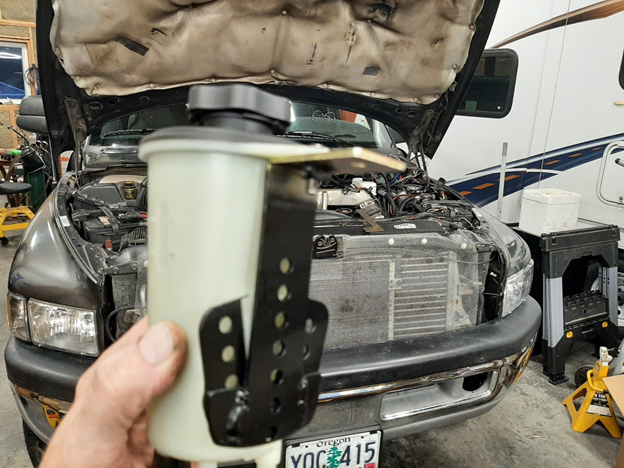

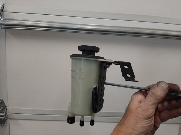

In the photos below, more brackets are added to fasten the unit to the engine.

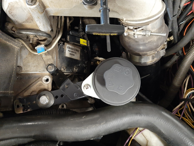

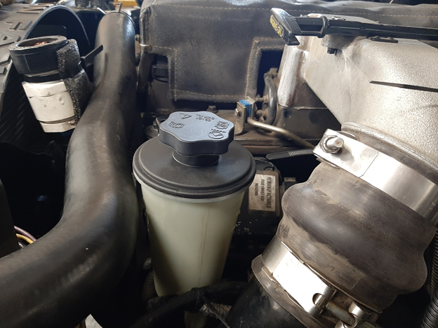

Below is the new location for the reservoir in the engine compartment - lots of space available for mounting with the removal of the APPS mounting assembly.
The time and effort spent on this project (and the previous APPS relocate project) has been very worthwhile. Much engine space has been freed up and the power steering reservoir is right where it should be for easy fluid check / fill. The reservoir is like the brake master cylinder reservoir – you can see the fluid level through the reservoir.

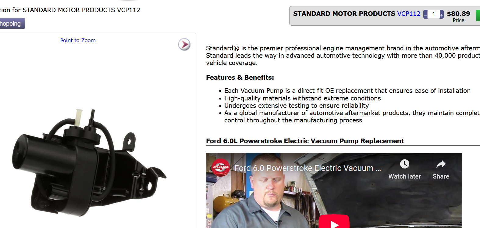

What vacuum pump did you go with? I have an electric on my Ford conversion. The power steering pump is similar to what you posted and is driven off the rear of the air compressor.
I went with Standard Motor Products VCP112. It was used on Ford vehicles, I think. The pump is noisy, but can't be heard with the engine running. It does the job well for operating the HVAC system and the 4WD CAD unit without using a vacuum reservoir. It is not adequate for the use of a vacuum operated exhaust brake.
