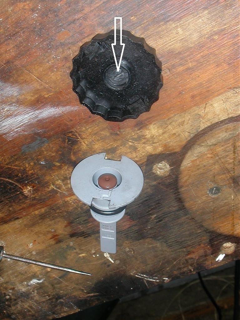

I have been looking for the orig thread pics but am unable to find them in the various forums. Maybe too old? Regardless, if I recall correctly, the fix is just to grind down the "nubs" that are indicated by the arrow so that the brown rubber stopper can come up enough to release pressure.
Update:
Post #10 here: https://www.cumminsforum.com/forum/...6051-pressurized-power-steering-cap-part.html
I think the image prob is due to my company blocking them, so you may be able to see the pics.
Actually, you buff the flap to thin it. If you grind the nubs it puts seal directly in contact with the cap and prevents it from venting at all.
