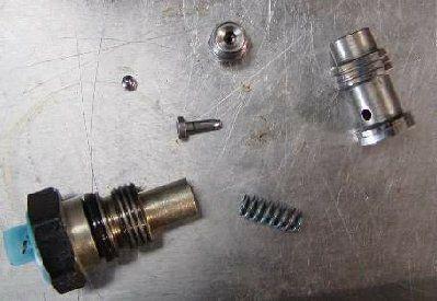

Essentially you remove the pressure line from the pump. Behind the big nut that the line connects to is the regulator valve. You disassemble it and clean the screen. Don't lose the little ball bearing that is inside. The screen is 11mm and is a chore to remove. I clamped the valve in a vice and used a box end wrench.
ok, CLEANED MY ALREADY CLEAN SCREEN, STRETCHED THE SPRING TO 2 AND A QUARTER INCHES, FILLED WITH SYNTHETIC AND BLED THE SYSTEM AT THE HYDO BOOSTER, NO IMPROVEMENT, DOING SAME THING IT HAD BEEN, IM HOPING A NEW PUMP WILL CURE THE PROBLEM, I SAW A TREAD WERE SOMEONE COMMENTED THAT THE BORGESON HIGH OUTPUT PUMP WASNT WORTH THE MONEY, I GUESS ILL GO TO THE LOCAL PARTS STORE ORIELEY OR NAPA, DOES a rebuilt pump come with the regulator valve and and springs ? Any input would be appreciated, thanks guys
