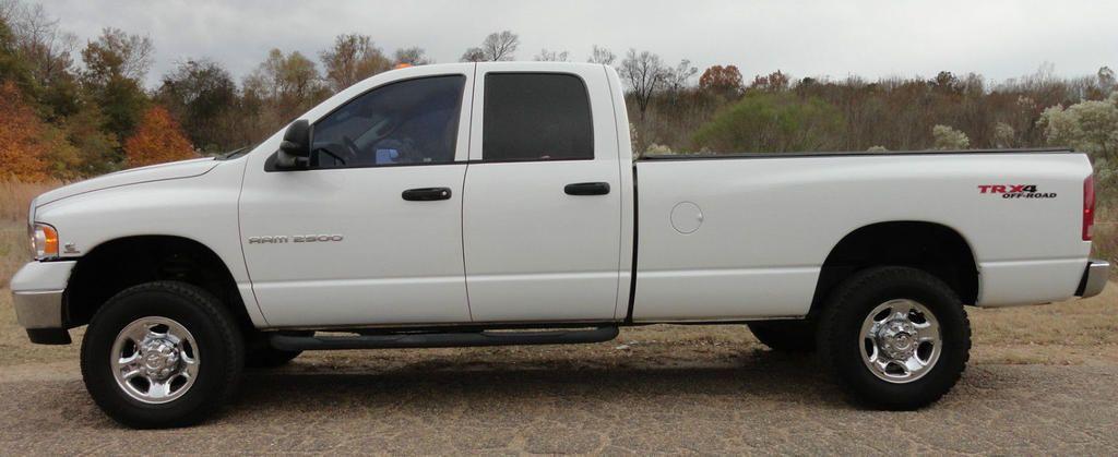

I picked up a Diablo Predator and downloaded the performance and then extreme download. I notice it the torque converter doesn't stay locked up when floored. I figured, but wow it really moves. I'm guessing full billet transmission is next.

I just remember it accelerating and shifting through each gear. I just didn't think it would drop unlock the converter once it locked. I would think that would keep it from getting so hot until it obviously shredded the converter. I know slippage builds heat and I know all that extra power is not held by the stock transmission. I really baby it, I just wanted to see what the power felt like. The predator makes huge power, especially for the $75 I spent on it. I am going to turn it down and still baby it till I get built. I also have a 1981 crew cab Cummins conversion and a 2000 dully with a blue chip that makes 320 hp and 730 torque. Both are a lot of fun and the dully pulls 13k @ less than 700 degrees egt. I love these trucks!

I'm trying promisedlandorganicfarmer. There isn't much done to the 03, just straight through 3.5" exhaust, CAI, predator and gauges. promisedlandorganicfarmer you got a nice truck there and some nice mods. I am thinking a larger turbo would be nice, but I think the transmission would need work first. It's in perfect condition, but won't be for long if beat on.
it looks perfect for sure! extra clean stock look is soooo nice!

When I saw this 03 with no rust and so clean looking I just couldn't resist. The truck does really well for fuel mileage. If I am cruising at 70 it's over 23 mpg. The truck has 300k on it, but no leaks or maladies I can find. It is broken in for sure and I have heard the 03 and 04 are the most efficient.
I know right, but I really think take care of maintenance, highway miles; break that engine in and give me some over the road mpg. It just runs so good!!! The predator kicks butt on this 03; really solid...
