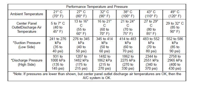

This is from the 99 service manual
Thanks DavidC. Having values of low side pressure and the vent temps helps a lot. It reminded me that the center and side vents do differ. I believe when I measured mine last summer it was around 55 degrees F at the center vent. I also had forgotten about using the recirc. I do a lot of short hops to town but if I don't set things before I leave it's more difficult to do on the road as I am in mountainous terrain. Take your eyes off the road for a second and some critter or fool is in front of you. All this reminds me that I should pay more attention to my settings before I leave. Possibly a new personal motto should be "Slow down Mike. You are retired".

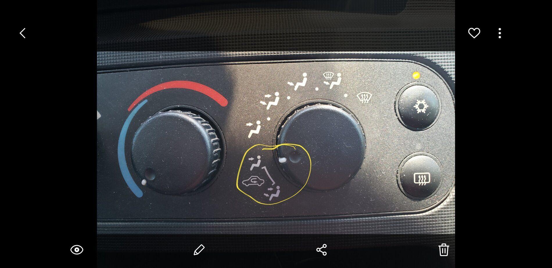

I'm in AZ also, and agree about the recirc mode. On the AC system on these trucks, how do I make sure that it is in recirculate mode?
Never mind, I found the AC Recirculation setting on my 2004.5. Interior temps immediately dropped almost 20 degrees compared to the non-recirc setting! Now pumping out 40-42 degree air, driving in the city, in 100+ degree temps.
