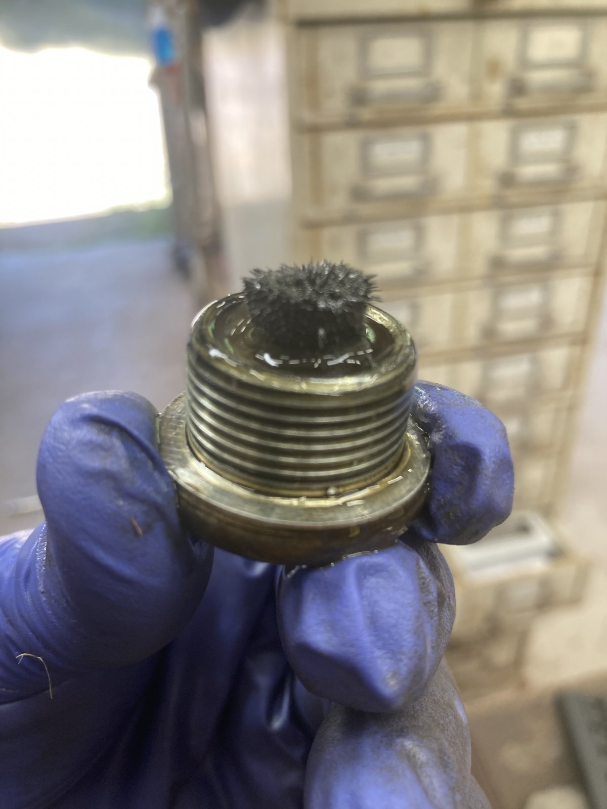

This is a pic of the G56 magnetic drain plug when I removed it with 50k miles on the Delvac 50.
Looking for informed opinions on the amount of metal ??
