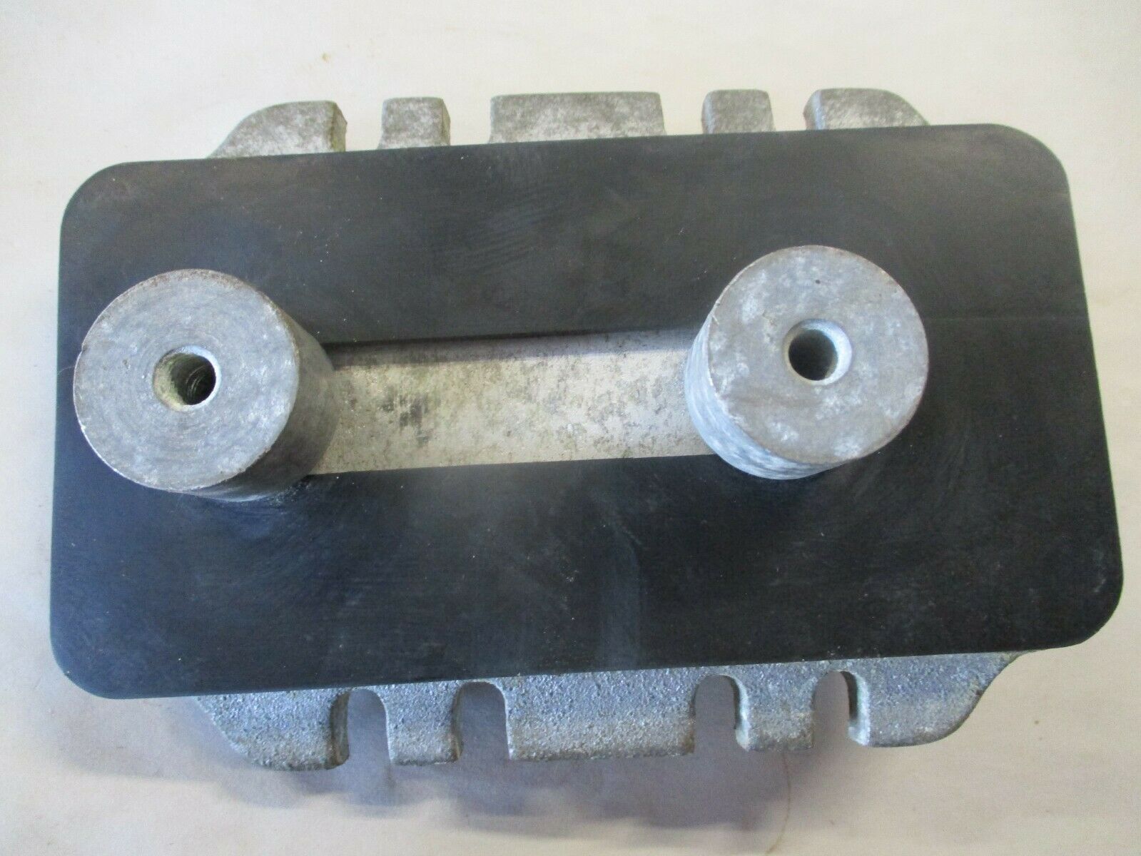

This is what the bottom of one looks like, "borrowed" from an eBay listing. The very important nipples are missing. And the bosses are not turned to accept the slip-on rubber nipples, so this is probably not the correct model.

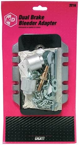

This is what the adapter looks like, in a shrink wrap. It's stolen from an Amazon listing that shows it as unavailable. It looks complete, but I can't see the nipples inside it. They are critically important. But I am not certain of the model number. Note that the bosses are turned to accept the slip-on rubber nipples.
