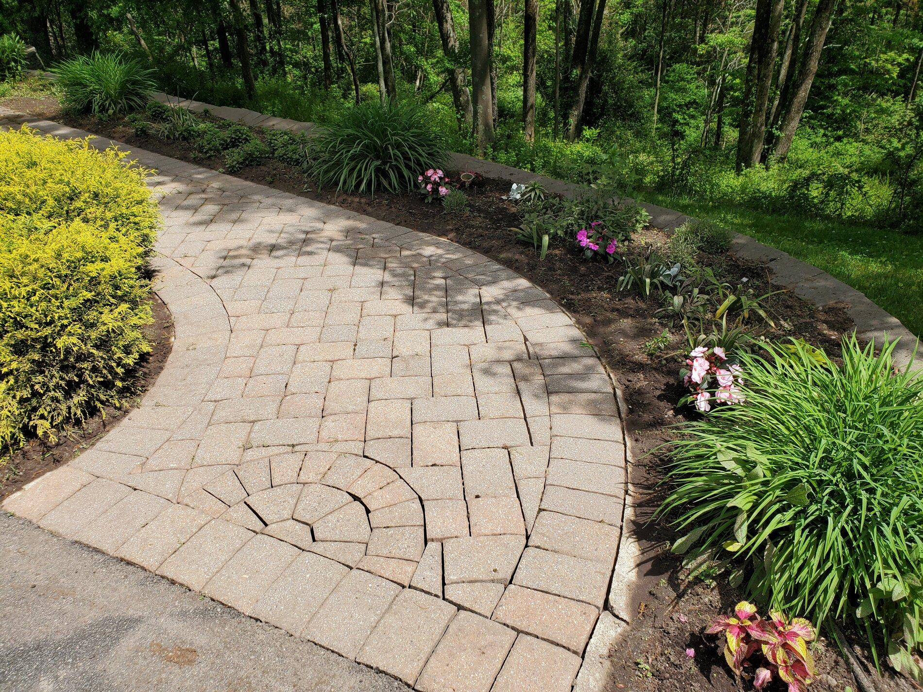

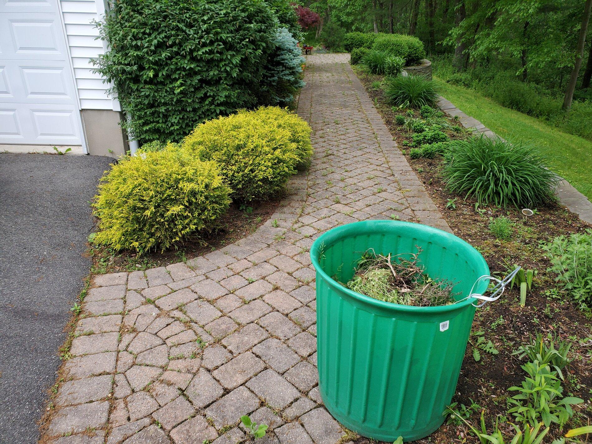

Just did some this weekend on my front walk.
