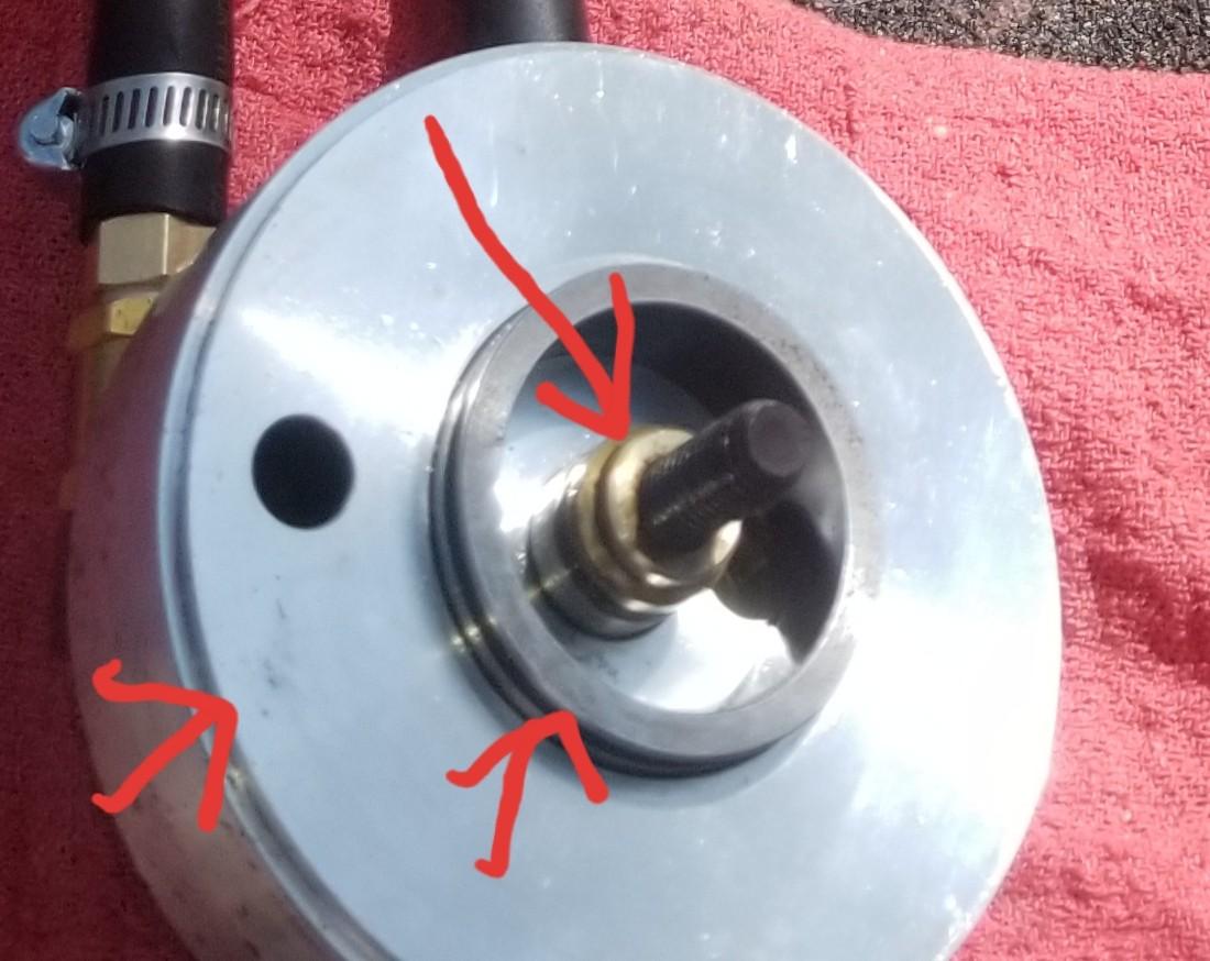

Ok so my truck has the Primeloc fuel filter relocation kit on it. Well it has sprung a leak, narrowed it down to one or three gaskets as fuel comes out between the adapter and filter bracket. These gaskets are nitrile/square cut and not available anywhere locally. I spoke to Ashland Technologies who developed this product and they are sending what may be the last know gaskets they've got sitting on a desk (they are not sure if they are the correct ones so it's hit or miss when I receive them and find out). The gaskets are somewhat deformed from being compressed for so long so I'm finding it hard to be able to get an accurate measurement of dimensions. I'm thinking I may have to send all 3 gaskets to a supplier to let them find a match. So while this is in the air I'm wondering if any of you guys have the stock can filter housing sitting on a shelf and maybe even filter on hand I could buy. I'm thinking worse case scenario I may have to convert back to stock until the gaskets are figured out as my truck is out of commission until this is figured out....
Have you thought about asking Ashland for the spec's?
If they can give you the specs's "theoringstore.com" may have what you need.
I did ask them and they said they did not have the spec's on it and parts for the kit are obsolete but said they used off the shelf gaskets. Patiently waiting for arrival of the one's they're sending with my fingers crossed..
