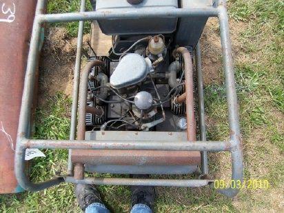

"I have seen 30-50 year old Onan's running perfectly". Do you mean like these? I bought the 4 cylinder unit at auction in 2010. After a little electrical work, it runs perfectly. It would probably cost Onan about 10K to make that generator today.
