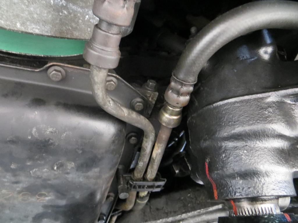

Remember the harness along the timing cover being in the way and the fluid supply & return lines from box to pump wanting to penetrate the harness? Well I guess I got lucky because all I ended up having to do when reinstalling the harness support brackets was to bend the one closest to the box backward, which when tightened provided about 1/4” between the harness and the return line. I then released the fastening snap device that holds the 2 trans lines along the block re-bent the 2 lines (no fancy tools just placed a wrench between the box or oil pan and “tweaked” by hand) so the one wasn’t pressed on the side of the box and the other didn’t have too tight of an angle on the hose to cooler.

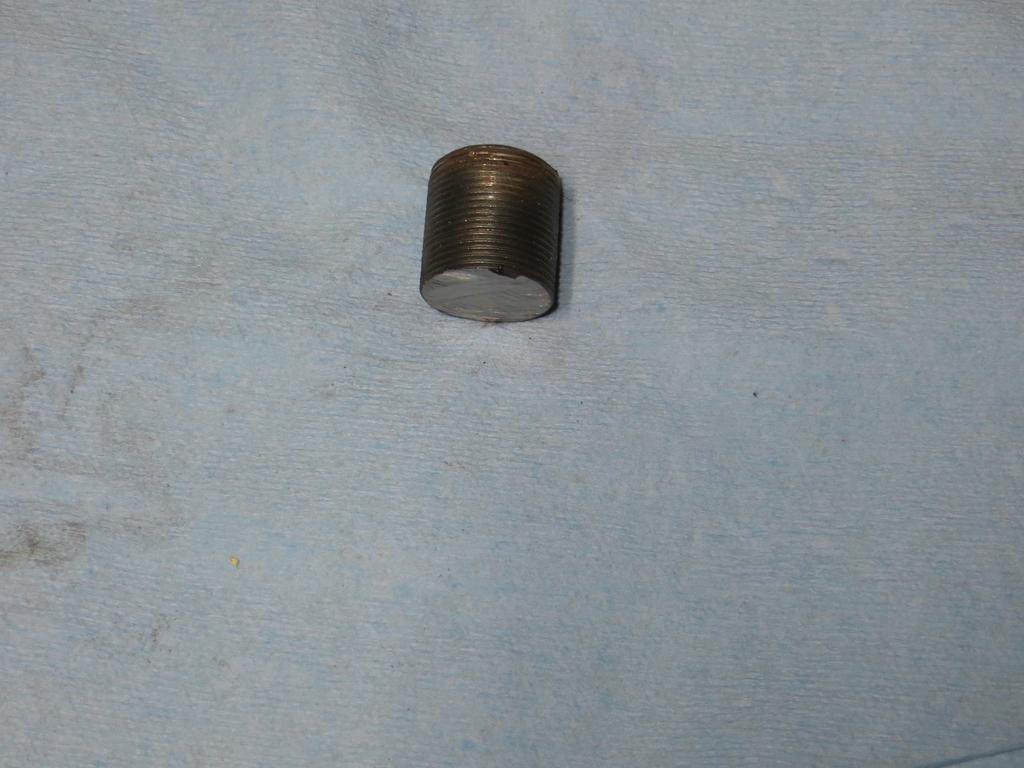

Next “should have been” the easy part = install pitman arm and drag link end joint. Pitman arm, fully lubed with anti-seize just in case, went on without a hitch. Now the good part, PSC Tech Support said “if” you have to use the spacers you’ll probably have to “adjust” the drag link to get the joint into the pitman arm hole. Well, even though (years ago I replaced) the drag link sleeve, drag link and end joint were fairly free enough to turn with a small pipe wrench once clamps were free I ran the sleeve until the link and end joint bottomed on each other in the sleeve and guess what, still an inch from dropping in to the pitman arm. Oh boy was I real happy about that, not. I decided to cut off 1” of thread from the end joint instead of equal amounts from the drag link and end joint just because I didn’t want to risk damaging the joint at the end of the drag link taking it off to place in the vice and grinder wheel off some thread. Once I cleaned up the threads and threaded the end joint back into the sleeve I was able to get the joint into the pitman arm and after much up and down I got the steering wheel centered.

Trans Lines after being tweaked
The 1" section I had to cut from the end link
