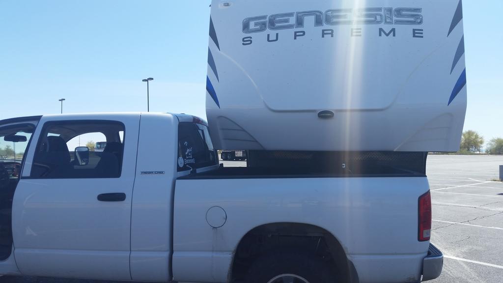

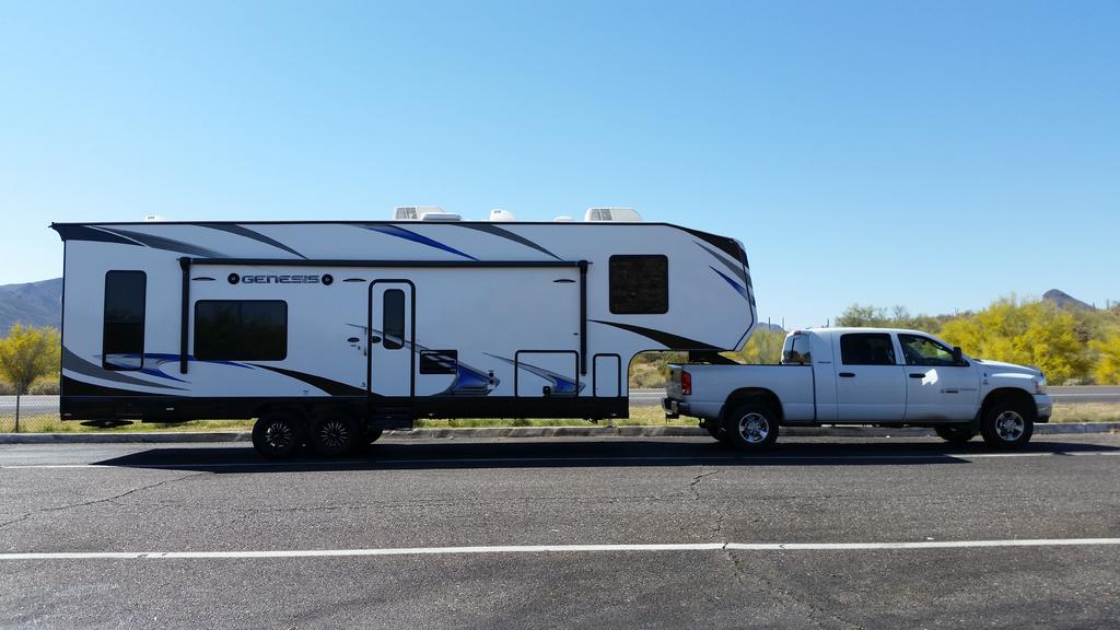

Well, we finally pulled the trigger and sold our '05 bumper pull 30ish foot Wildcat and bought a '16 Genesis Supreme 33CK 5th wheel toy hauler. I drove from Reno to Phoenix to pick it up, took it to Tucson to visit my folks, and then back to Reno.
Overall, very pleased with the way it pulls. We got the Pullrite Superglide after many hours of anguishing and reading. I actually got an Andersen Ultimate but wasn't sure that it would provide enough clearance with the Megacab short box. Backing was a new experience but I'm sure I'll get the hang of it. I also put bags on the rear to help hold it all up. Mileage? Well, on the flats in AZ it was good at about 11 or 12 according to the overhead. The hills and headwinds in NV knocked down into the 9's but I guess that's pretty good for pulling a barn!
Just a suggestion - check the tires on that new 5er. If they're no-name China bombs, get rid of them as quickly as possible and get some decent shoes on that new rig before you're replacing side panels, wiring and piping.
Congratulations on the new toy hauler.
Rusty
Looks awesome. Don't let it sit around and I hope you enjoy it.
