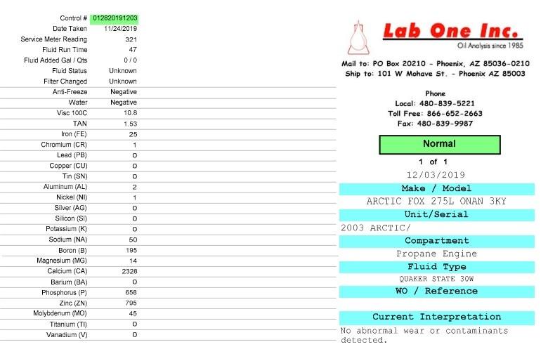

I don't see where they tested for coolant in the system.
Sodium and potassium is coolant. Both numbers are very high compared to my last 20 samples. Silicon is high too unless the oil has about 25,000 miles on it.
Why is "Aluminum" in GREEN? Is 18 high?

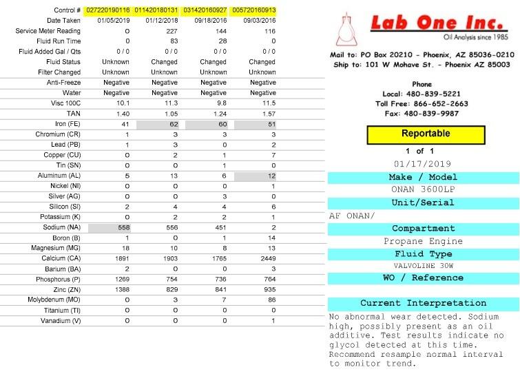

It is a simple matter to google how coolant in the oil wears out bearings.
As far as his numbers are concerned they are in line with my 15k ish intervals on my 14.
Blackstone labs results only show potassium and sodium too. They are not a part of the oil additive package, they are contaminates and listed as such.

Maybe my lab was just guessing.
I guess I should have looked at the whole page. Now I'm wondering if you have the Onan running while the RV is going down the road. And yes, the word "possibly" does mean they are guessing.
You have the patched up 53 block right ?. Sounds like it cracked inside also.So here is an interesting tidbit . I just dropped the oil and about half a gallon straight antifreeze came out
