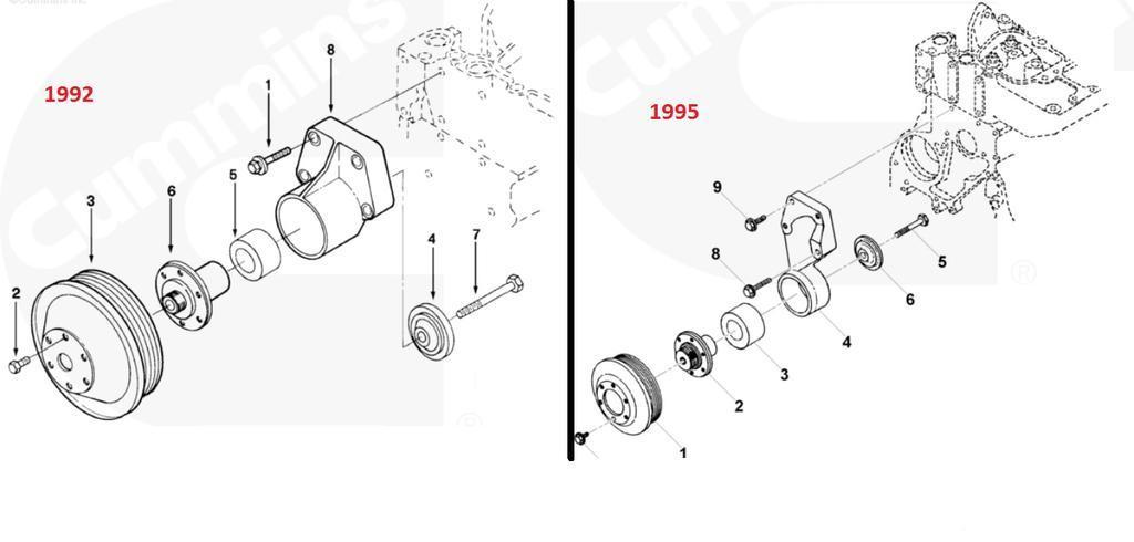

Your issue is mix and match parts.
The fan hubs are totally different from the '92 to the '94, the fan is lower on the 2nd Gen engine.
From the looks of these Cummins drawings they bolt in a different location. I don't know for sure but I think they have the 1st Gen wrong and they bolt in the same place.
Also, the '92 belt w/A/C and Intercooler is an 83 3/4" belt and the '94 is an 81 5/8" belt. The tensioner is the same.
I have not pulled off the fan hub , however i think the fan hub can only bolt on one direction , but it could be the belt its self ?? If there is a length difference ???
