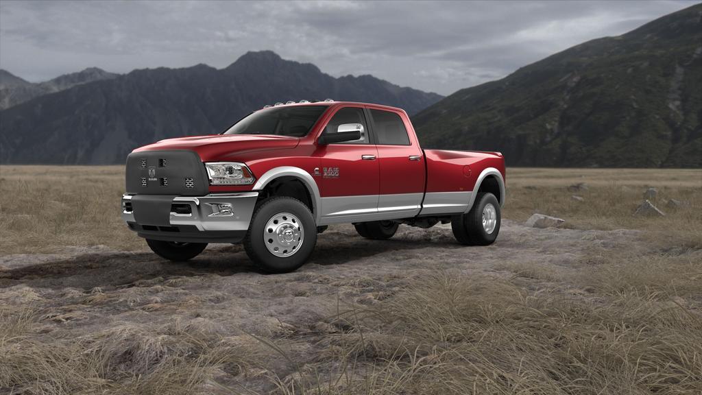

2018 6.7 4:10's Aisin pulling 18K. What do you think the MPH on a 7% grade at 5000 feet will be? Out side temp 100 degrees
18K Trailer. Thanks guys. Truck's on order. :)
Maybe it's because I have one but I think the 4th Gen DRW's look nicer than the SRW's. Just the way the fenders flow into the bed.
