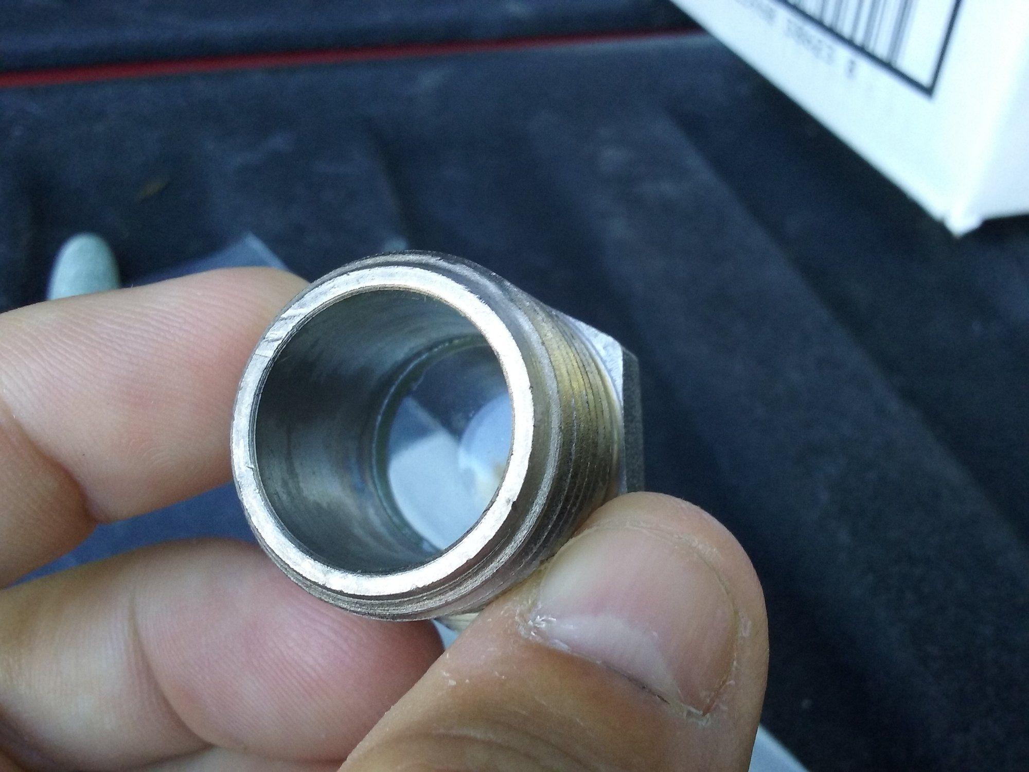

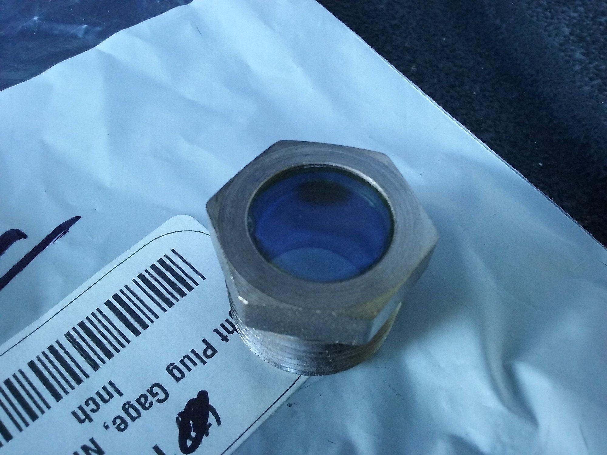

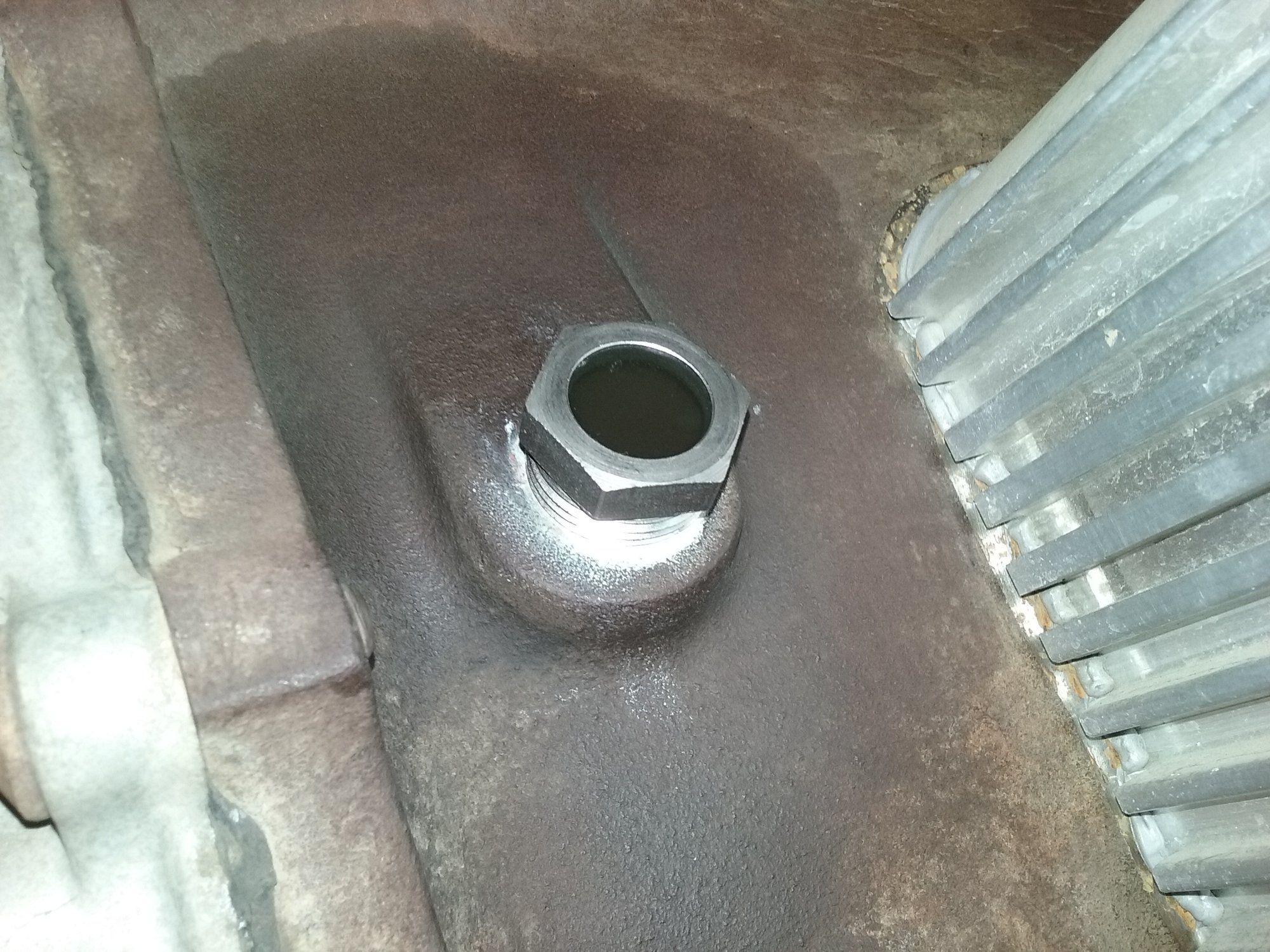

I also have a full 7 quarts of SyntorqLT in my 4500. With the Fastcoolers taking an additional quart apiece, thats almost one quart overfilled. I filled it through the top when I had the tower off. Been like this for about 6 years and lots of towing. The ONLY reason you'd ever compromise seals is if the vent was plugged. And...that would happen at factory fill levels too.
Here's a picture of the sight glass I put in the fill hole. You can see nothing but fluid...

I'm sorry but I cant remember where I got it. If you comb through the internet for sight glass plugs you'll find plenty of sources. You just have to find the right thread and size and make sure its capable of withstanding heat and chemicals.
Here's some additional pictures which may help you. And if I find where I got it I'll be sure to let you know.

Well there ya go...
No. I'm familiar with the Fast PTO cover with a sight glass. Thesight glass from the cover may fit the fill hole?, But I prefer to find the sight glass seperately. And would like to have the sight glass to replace plug for fill hole on the transmission case as pictured in your post. I'll search online and in the meantime and if you remember where you located the plug please let me know.
