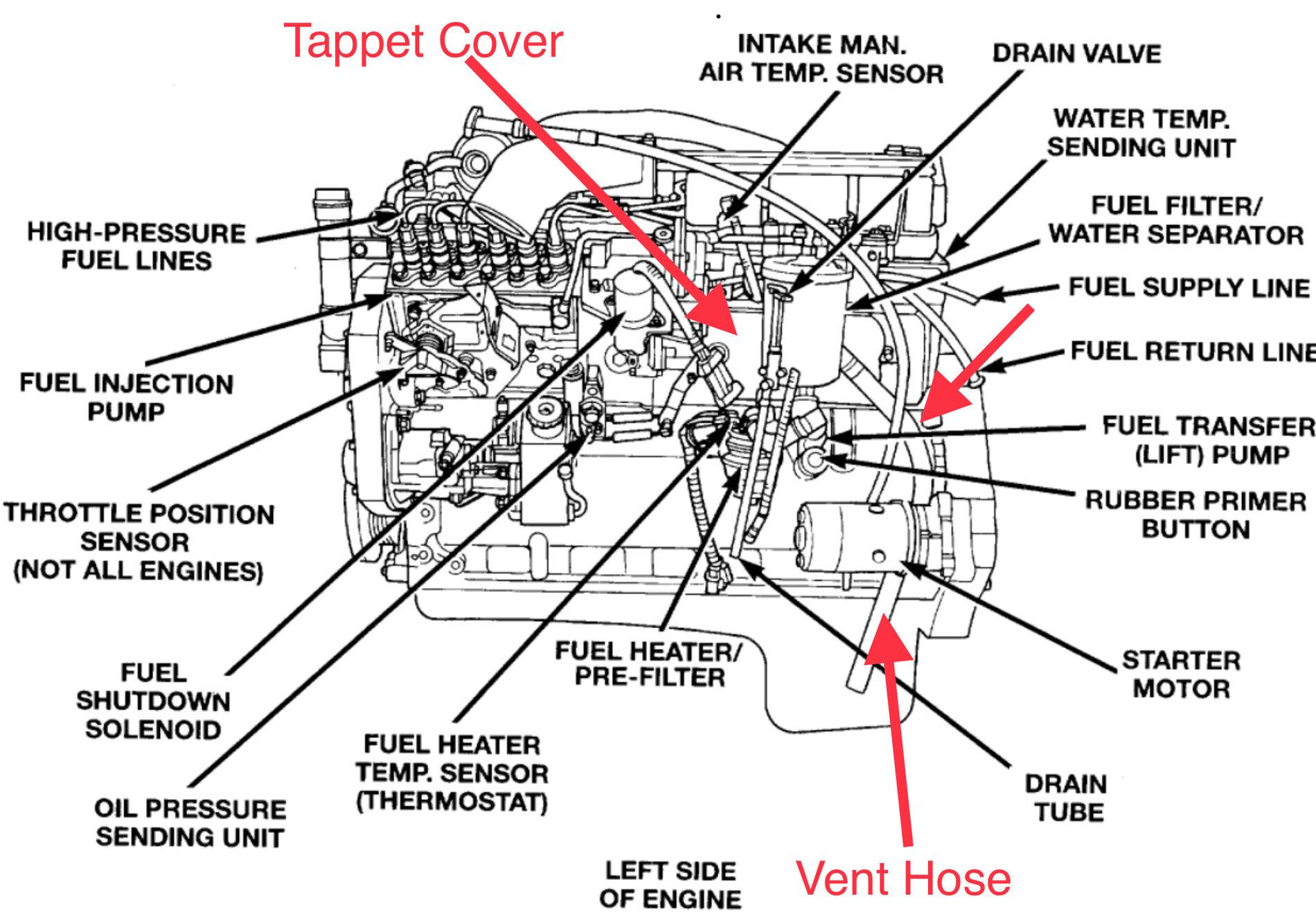

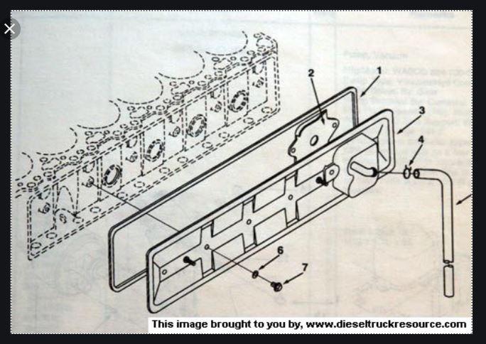

I believe the second generation 12 valve engine crankcase vent is located on the rear part of the tappet cover on the left side of the engine. One the second generation 24 valve engine, the crankcase vent is located on the timing cover.
Hope this helps.

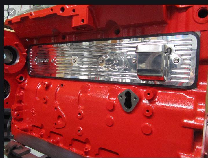

Stock CCV
Modified CCV.
I see no vent hose on my engine - which could explain the amount of oil I'm finding on the lower back of the engine.
Thanks BP
That leaking pan gasket you mentioned might just be due to the missing hose on the tappet cover. Although I have a 24v what I did to the CCV hose on the timing cover for mine was to extend the hose (in a downward slope) back to the transmission/transfer-case area. This way the oil mist doesn't clog the radiator etc. and provide that infamous 2nd gen auto chassis lubrication system. In your case, if you extend the hose/missing hose, you might not actually have a pan leak/weep.
