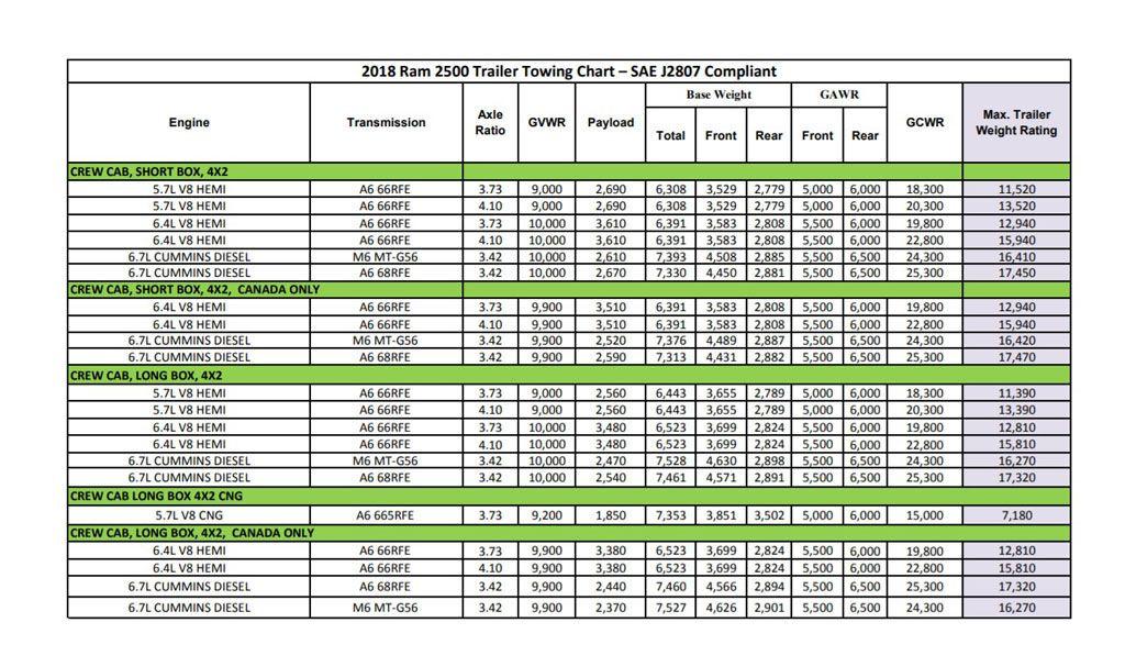

Hello,
Looking at the 2018 2500 towing guide numbers I see following numbers for my 2018 CC 2WD 68RFE:
- GVWR is 10,000 lbs
- F-GAWR is 5,500
- R-GAWR is 6,500
Adding up those numbers it looks like it is possible to be well over the 10k-lbs GVWR, but still well under the max GAWR of 12k-lbs for both axles combined.
