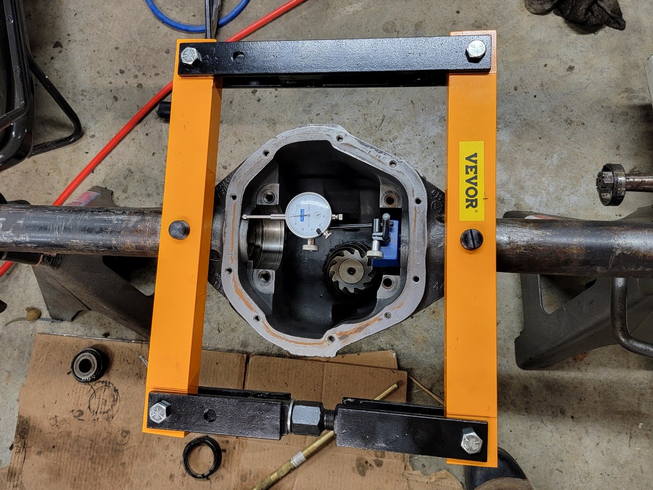

On the spreader, I have 3 rears to rebuild so I thought it would help, the Dana 44 the shim go under the bearings not behind the cups.

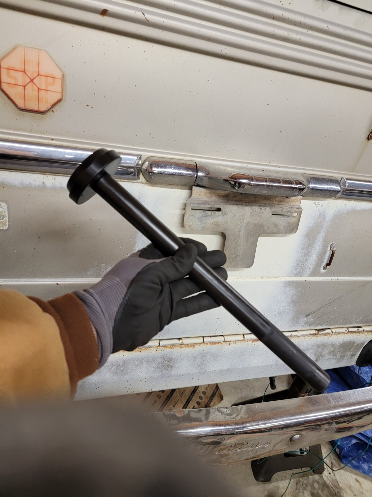

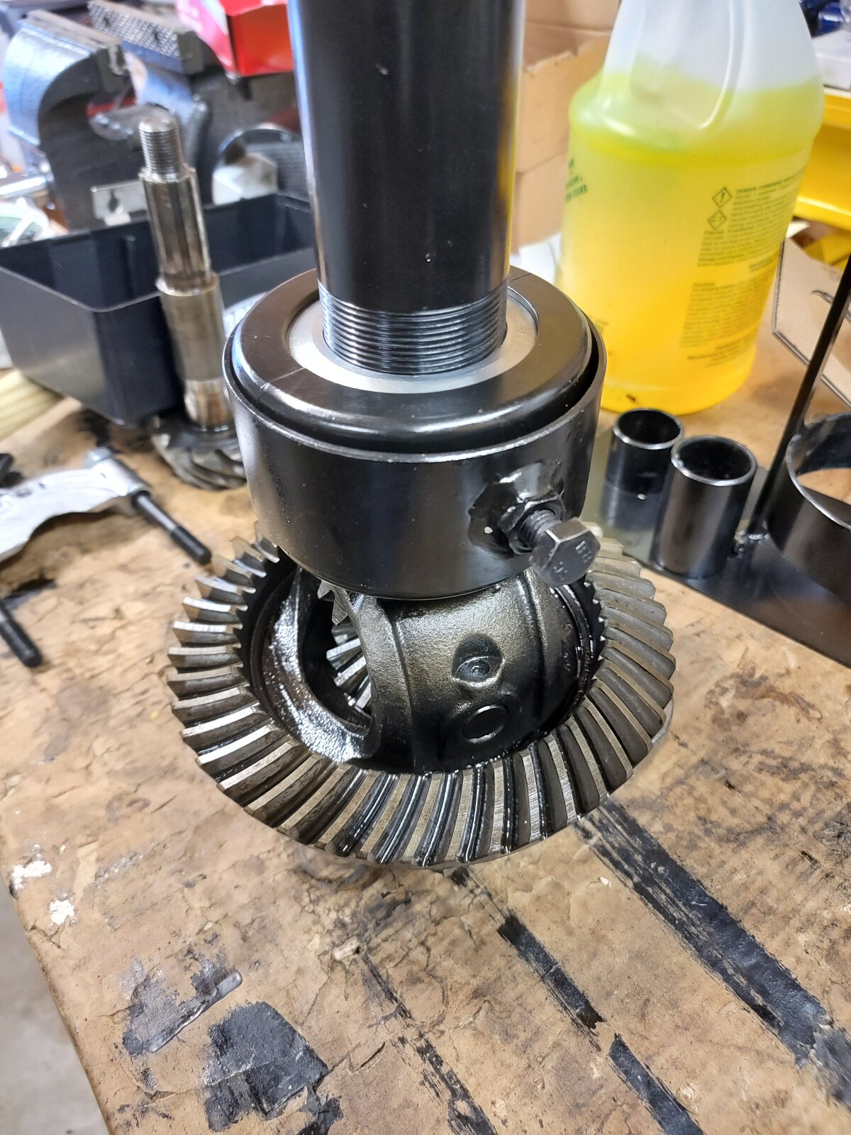

With this new style bearing puller it's 15 seconds to pop the carrier bearing after about 30 seconds of set up, maybe 2 minutes max if the tool is on the shelf, it's crazy once you use it.
They no longer make the Dana 44 set up bearings, you can buy a second set of bearing and enlarge them, but I also have a Dana 25 to do.
For just a second set of bearings to enlarge would be $73.96, the case spreader was $118.39, so a difference of $44.43, if I added the Dana 25 bearings they would exceed the cost of the spreader.
The spreader works nice on the bench and again it's pretty crazy how precise that thing is you can dial in the spread to the .001", it's almost zero work, the spreader is 40-45lb so it heavy.
For me it was not a huge cost item, but it's a gimmick for sure that you would not need for a one off, they show a 5lb dead blow to tap in the carrier which is easy peasy.

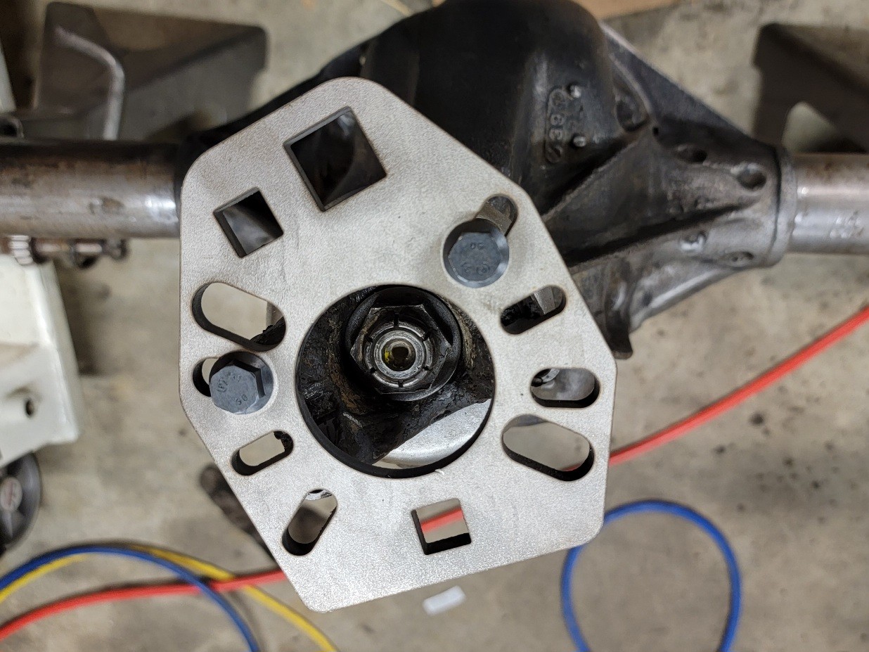

Here is a photo of that bearing puller deal.

For those saying the spreader is a gimmick, you'll have to explain why the FSM and even the DANA service manuals say to use one.
Worn bearings = no preload.
No spreader? No preload.
Mexican Version? Beat the carrier in - preload accomplished. No spreader needed.
Just replace bearings? Same shims go back in as manufacturing tolerances of the bearings are a fraction of even the thinnest shim.

Maybe gimmick was taken the wrong way, its stupid simple how these spreaders work you can basially almost spread it by hand once hooked up on my little Dana 44. There are often tools that to me are so simple and that's the gimmick part, if you did an infomercial on a spreader I'm not sure I would believe it.
But they also show using a 5lb soft dead blow when one is not available in the Torque King manual.
The Torque King book is a good read, it's cheap and provides a wealth of real world knowledge to the smaller shop / DIY person. They have pictures and descriptions of both methods. The person behind their manual is pretty amazing with the shared knowledge he provides on these differentials.
The spreaders work amazingly precise, you can dial in the spread to the .001", but for a single rear it's still a high cost for overall project budget for something you will use one time. If one was able to.borrow one local or do the free rental, I say grab it. I have a healthy tool budget so was easy purchase for me.
