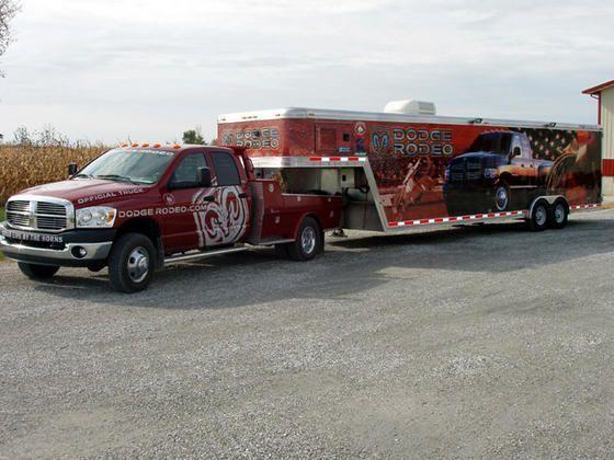

No thanks. I don't care to join the B&W fanatics. I have no quarrel with those of you who joined the club but I have no interest in joining you wearing the "I've got a B&W hitch badge. " Did you notice that Ram made the same decision I did? Perhaps Ram decision makers were not aware that B&W has a connection with rodeo cowboys.
I doubt that.
Hey Rusty, maybe you don't remember, but back in 06 you posted a pic of a similar picture and the rest is history. This was your fault :-laf
