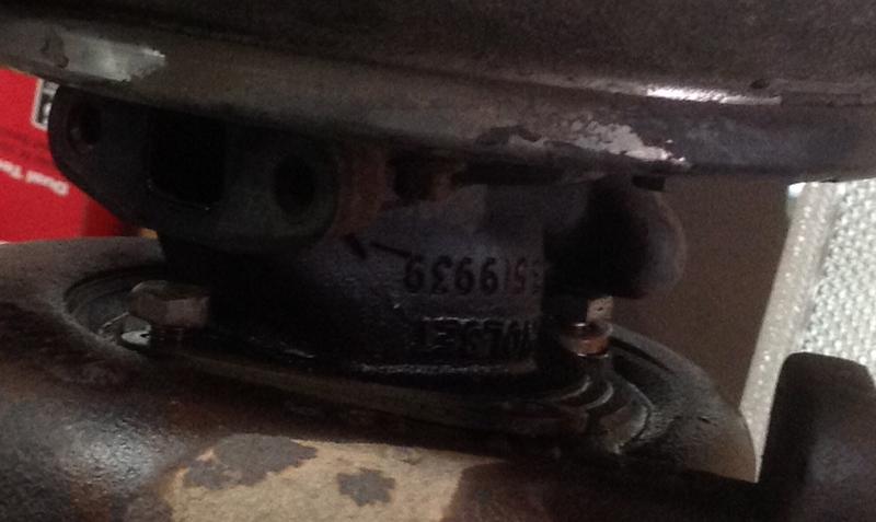

A couple years ago i picked up an untweaked 92w250. I'm swapping my 21cm turbo exhaust housing for a 16.
I could not get the hot side separated on the truck, so I removed the entire turbo. I was surprised that there was not one drop of oil when i removed the oil feed and drain lines. Is this normal for it to be so empty (drained)?
It is currently soaking in Kroil... ... Any tips or tricks on getting it apart? I've marked it, and i know to take it apart carefully, while keeping vane clearance. I think it's gonna tak a hammer:eek:
I've got the manifold gasket, and oil drain gasket, and will use a little anti-sieze when going back together. I'll tap the manifold for a pyro. Anything I'm missing?
Done. It just needed a bigger hammer. I went to put a few ounces of oil in the inlet before hooking the hose up, but it wouldnt really take any. Kinda acted air-locked. Having never taken a turbo apart before, i expected there to be some oil in it. Will see how it drives later tonight.
