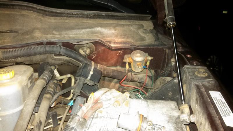

Also, is the solenoid on the firewall in the pic below stock? I am guessing no, but there is some shaky wiring elsewhere that I am trying to eliminate so if this is stock I would rather be working on the speaker wire that is feeding power to something......

No, the solenoid isn't stock nor is the thing that's just to the left of it zip-tied to the harness. Sometimes people use those solenoids to cut power to the charge wire at the 7 pin connector when the ign is off.

The zip-tied item is a battery tender. That is an interesting thought on the solenoid. It looks like the wires head back under the cab so I will see if that is where they go.

Looks like the original owner never once washed under the hood. That is charge isolation solenoid for the trailer charge lead. Chris
