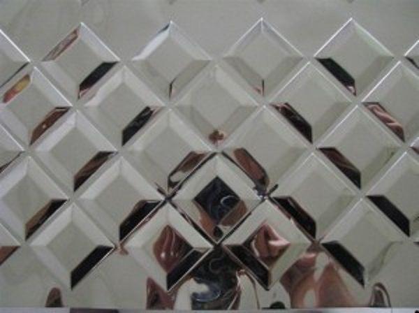

Looking for ideas on attachment of quilted stainless sheet to rear of trailer loading ramp?
Could pop rivet the edges and cover with a cap so as not to see the rivets but wondering about the field of the stainless would it need to be glued? if so what kind of glue would accomplish such a task.
BIG
Unfortunatly the EPA has ruined most bonding agents, so the first question would be how permenant do you want it to be? The next question is, will it be eye candy, or as you mentioned the ramp, will it be used as a surface for a nonslip flooring? I would use stainless rivets with a rubberized glue. If both surfaces are smooth to be bonded and it would be permanent, I would rough up both surfaces and buy a fiber to metal bonding agent (don't know anymore of good bonding agents). I used to use a very strong bonding agent that bonded rubber to metal surfaces used at loading docks that could take constant pounding of trucks hitting the at the docks all day long. Whatever agent you use, make sure the surfaces are clean of any particles that were loose from sanding, clean and coat both sides allowing it to completely dry, then apply another coat allowing to become tack, then attach them. As an extra holding, as well as clamping to help the bonding, add rivets. If I remember the agent I used in the early eighties I'll PM you.
Attachment would be on the rear outside of the door which is also the loading ramp in this case. More Eye Candy or Safety as I see it, we had some days that were foggy on the Left Coast trip and thought that something shinny for the approaching headlights that reflects back at them would WAKE THEM UP!!

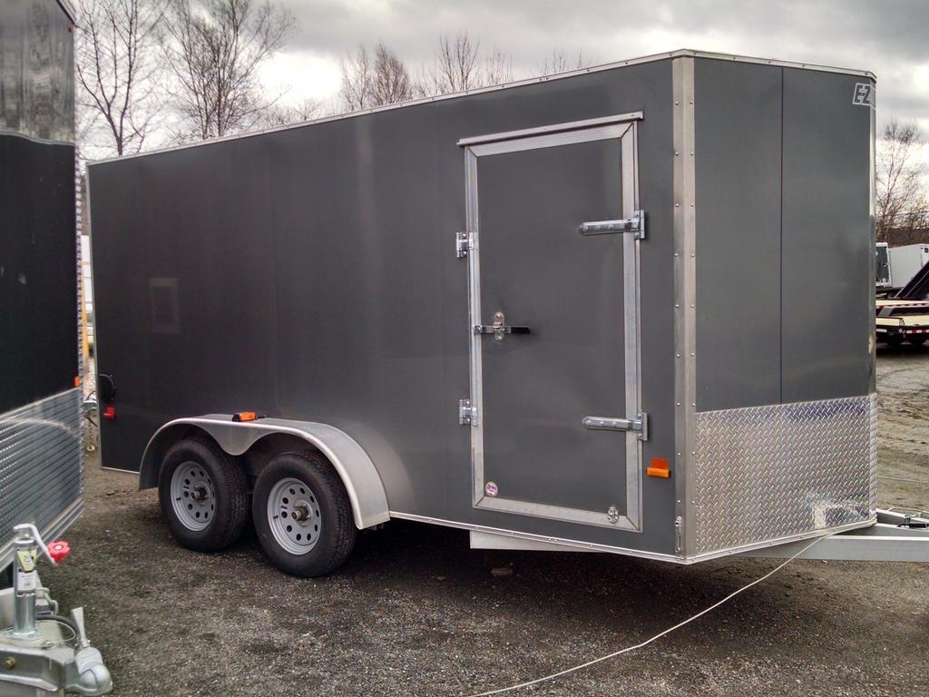

My new cargo trailer does not have rivets, there is some kind of adhesive that holds the side panels on....maybe call a cargo trailer dealer and see what the stuff is???
No rivets at the seams or on the uprights..
I recently saw a new Triton(expensive)aluminum box trailer that had failing seams(no rivets)all over the place. Don't know if it was a process or material issue, but I'd be plenty steamed.
The cargo companies use a 3m product can't think of the name of it but they use it on horse trailers some too.
I figure if mine ever bothers I'll pop the plywood liner out just long enough to buck rivet the panels. I have the technology here.....:D
I have not noticed any rivetless trailers running up and down the roads with bowing panels YET.......but that don't mean it ain't gonna' happen....

Talked with a Trucker Pulling a Curtain Van about how nice his Rig looked and said that I wished I could figure out how to attach some Stainless to the back of my Trailer. He gave me the info and said that its made by 3M and that he attached it to the doors of his Curtain Van. He had the Mirror finish on his and it DID LOOK LIKE A MIRROR!!! he's had it on for several years so it takes the road grime, washing pretty well.
http://www.topvinylfilms.com/index.php?p=home
Problem Solved
