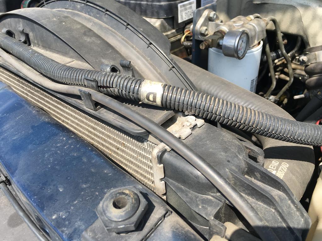

Are the OEM radiators in the 3rd gen copper? The 2nd gens are, and copper is every bit of a third more expensive than aluminum. Production quality aside, aluminum radiators are generally stronger, lighter, and cheaper. They can utilize wider tubes which results in more surface cooling area and fewer needed cores.
Fewer cores = less material = lower costs.
Couple 2nd gens I've had were aluminum/ plastic.
Is your OE rad copper or aluminum?
Just curious more than anything.
