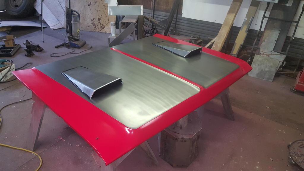

just sharing my latest creation, Im not done with all of it yet but when im done the scoops will be fully functional and feed a sealed air box
You need to do a little more research on aerodynamics. It was proven decades ago that forward facing scoops in that location are in a low pressure area as air vaults over the square front of the hood. Looks cute, does not work as intended. A rear facing scoop at the base of the windshield works, a forward facing scoop in the grill works.
KOG i dont know if it was your intent or not but that statement makes you sound like a real arrogant
Maybe it will work maybe it wont the point is its some thing I put a lot of work into it a simple cool or nothing at all would have be fine, the whole looks cute thing was not well revived, cause i really dont care if its aerodynamically correct or not
What he means is it won't work due to the aero dynamics of that big flat frontal area. It is the wrong place to put the intakes. It is a great idea, looks nice, but if it won' work as designed, and, I would hazard a guess you may actually reduce air into the engine.
Nothing wrong with pointing out discrepancies' in a design and explaining why.

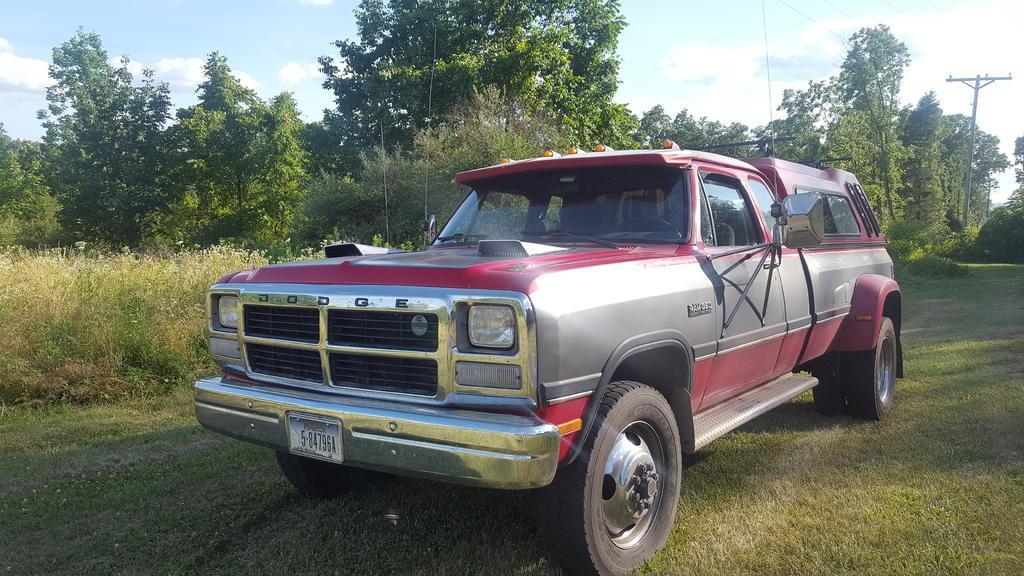

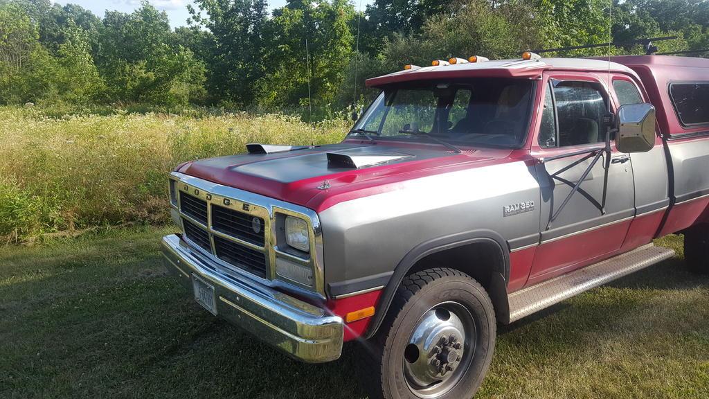

Well i haven't had time to finish the air box yet, but the scoops dump air on top of the filter, i have noticed around 0.8 to 1.0 mpg increase after installing the hood I went from 19.5 or 19.6 mpg to a combine average of 20.4 to 20.5 mpg
