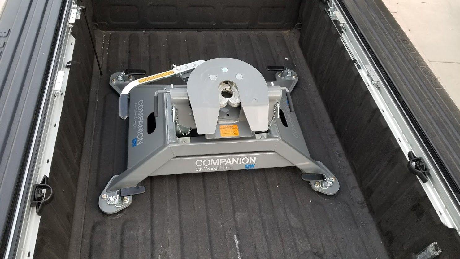

Greetings; I almost bought a 2500 version with the Ram Boxes; the sales rep repeated a bulletin that reports the 5'er Pin Box Assy. would rotate into the interior portion of the Ram boxes. So your experience is contrary to that? Could I trouble you for a pic sometime when the rig is in a turning mode? Thanks.I have a 2018 2500 CC SB Rambox towing a 33' Rockwood 5th wheel with Reese revolution pinbox.
Have used it for over a year and 11 camping excursions with my family. Very happy with this setup.
I installed the factory mounts myself, including the 7-pin connector to the LH rear of the bed. Not that difficult.
There is a detailed write up over on the cumminsforum with instructions on how to install the kit and cut the holes in the bed perfectly on center.
The Rambox suits my needs for storing stuff out of the way, and the 6" clearance I have between trailer and top of bed is plenty to open up the Ramboxes while hooked up.
Disadvantage is that you can't tow a trailer without a revolving type pinbox, Rambox not available on a long bed, and can't use a camper shell. Don't know about towing a gooseneck.
As far as instructions for installing the factory mounts, attached is what was included with the Mopar kit I purchased.
They say you have to loosen the bed mounting bolts and lift the bed one side at a time, I did not have to do this. I just worked with the truck on the ground using a creeper ling on my back.
