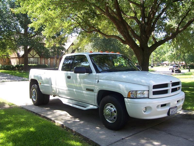

For reference, attached is a photo of my former 2002 3500 SLT+ Sport.
Rusty
Okay, how'd you do that?
Ummmm......I ordered it?? :confused: :D
Seriously, I did order the ETH/DEE truck with the SLT+ G package to get the leather, etc. and also ordered the sport package. I posted the picture to show how the parts fit together on a factory sport. FYI, the c-pillar badge says SPORT - the sport package overrides the SLT Laramie badging on the 2002.
Rusty

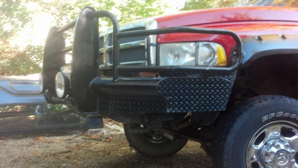

My version of a sport bumper :D
Not quite as "assthetic" :-laf but the ability to fold Bambi's big brother under my rig and spit him out the back in the form of ground hamburger at 60mph and keep on keepin' on is priceless ;)
Not sure about you but the deer population is rampant in my neck of the woods so this was my answer to preserving my front end. Make's it much easier to hang some mega watt candle power up front too
The sport bumpers definitely makes the truck look nicer and the best part is your using OEM parts. Not knocking them in any way. I crinkled my front bumper and actually considered buying a front clip off of a sport. But for the prices I was seeing, not to mention the added cost of matching the grill and bumper to my truck it didn't make a lot of sense financially especially given the way I use my truck. It was actually cheaper for me to go the Ranch Hand route.
