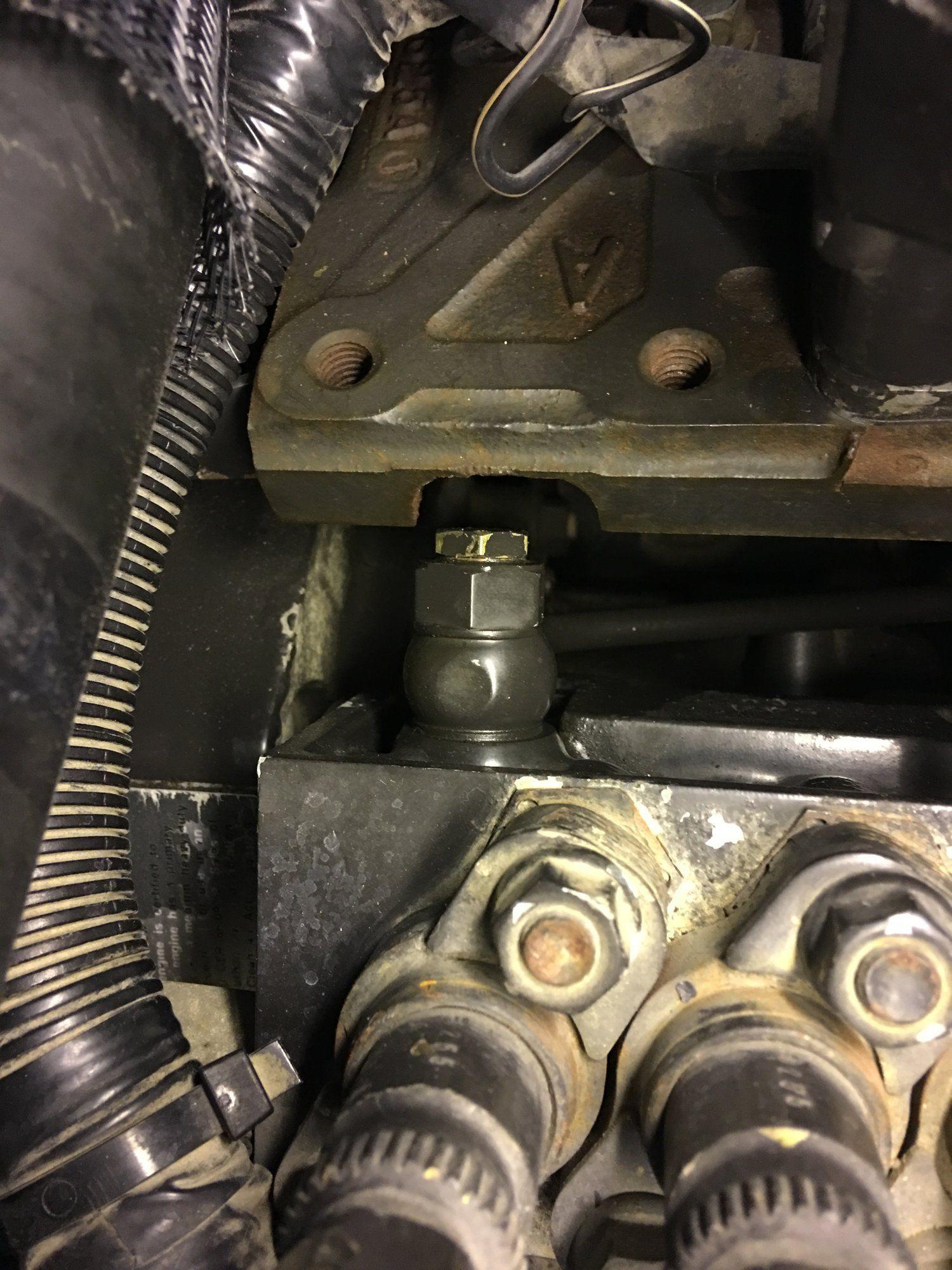

I'm wondering why the filter filled so easy, but I continue to get air from the 14mm bleed bolt in my last picture. Is the 14mm bleed bolt in my last picture I posted yesterday the return??

Should I be cracking the 14mm bleed bolt while pumping? Is that return? Should I see fuel there before I try to start?
