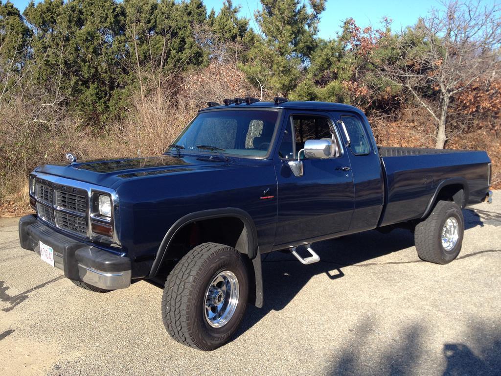

I'm hoping to do some upgrades to my rear axle for my W250 (Dana 70). Truck is mostly on the road, occasionally in the snow or on the beach. I need some adviceand have some questions:
1) Disk Brakes, found a good source for the parts from https://www.circletracksupply.com/e...dge-trucks-1988-1993-dana-70-srw.html?cat=495 Any experience or things I should be cautious of, or definitely do ? Will I have to change anything up front in the brake
system ?
2) 3:54 Gear ratio, standard rear end. Looking to upgrade to a Posi or locker (hate not going anywhere in snow). Not sure what is best or the real difference between them. What is best ?
3) Is there a later year or generation rear end I should look to get (maybe with disk's already as OEM) and build that rear up ? Would a later year axle housing even fit my 93 ?
Any advice would be greatly appreciated. Thanks, Kyle Takakjian

Nice truck.
