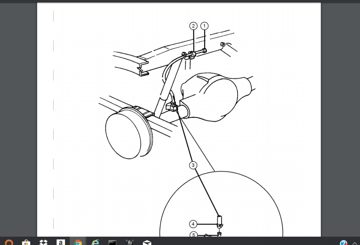

Walked out in the rain this morning to find the vent hose laying on the ground. The clamp the holds the free end rotted away.
I can't for the life of me find where it was attached. For now I zip-tied it to a crossmember.
I checked the FSM but found nothing about this line. Where exactly does it mount? And does it need to be vertically oriented?
If I recall correctly it attaches to the body member directly above the rear axle...
I’ll see if I can find an illustration in a little bit..
Like I said, I found no evidence of where it was. An illustration would help... or I'll just leave it where it's at now.
Part # 52114428AA
Ref # 2
Can anyone tell me what the white nylon looking vent on the end of the hose is technically called and do you have a MOPAR # or does Genos by chance sell this piece? (Doubtful I know)
Further, does anyone know if a suitable replacement for these vents are possibly available at local auto parts stores? I already know if I dont come 100% prepared, autozone or even NAPA will likely never find it in their computers.
The Vent is available from your dealer. My local dealer keeps them on hand so they must be a little popular...
Referenced as #1 in the parts breakdown I posted above...
Part # J5352955 List Price is $5.85
