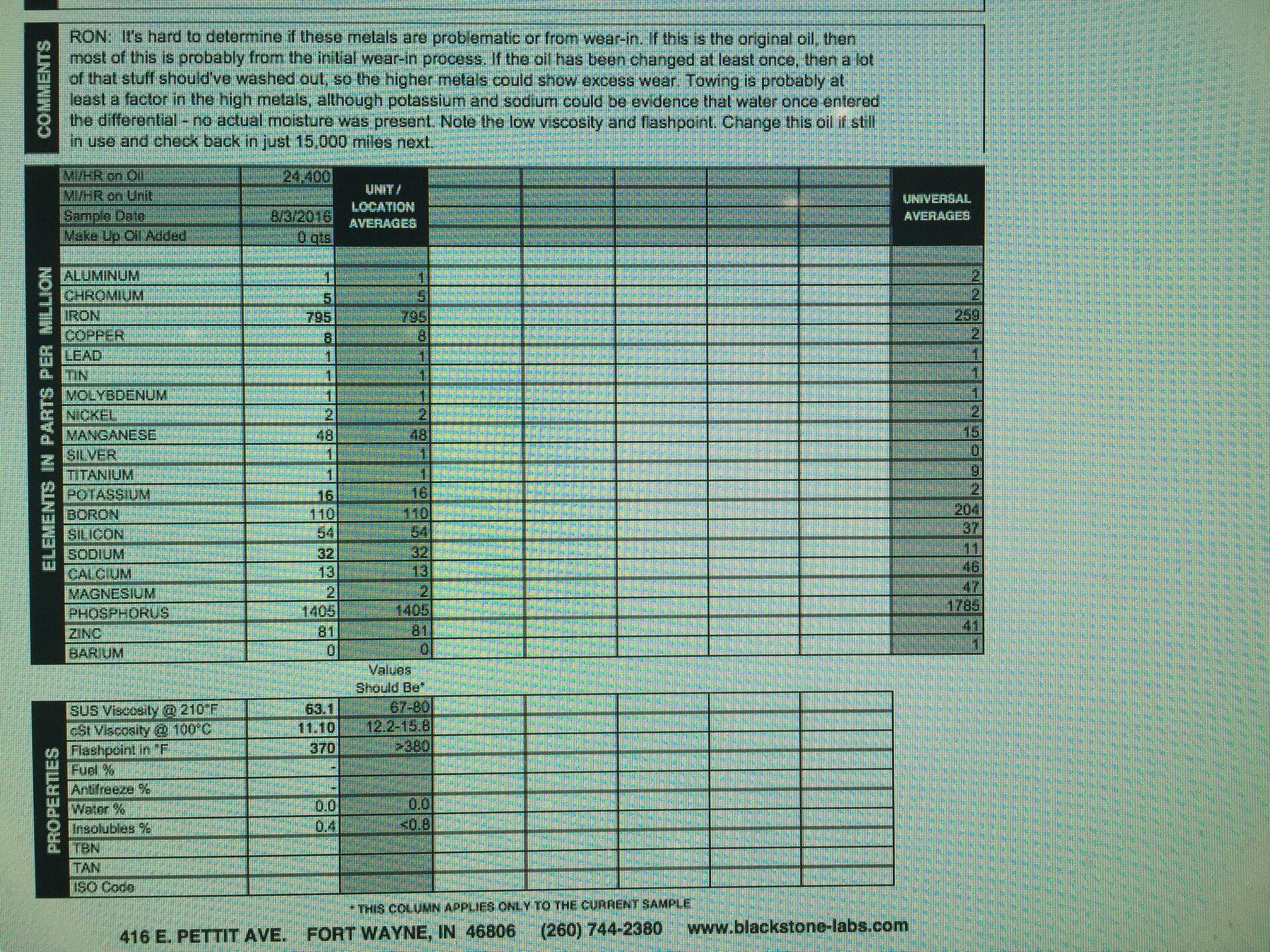

The manual states on my rear axle change, and IMO it is a bit vague, but every 24K if using your vehicle for police, taxi, fleet, off road or frequent trailer towing. I change mine at 40K, and the OE fluid looked great, no shavings etc. I don't tow frequently, so I felt like I didn't fall in that category. As said its vague on changing, so someone that does not tow heavy or frequently ,not sure about changing every 24K. Although it will never hurt to get the OE out, just not sure its doing any harm at 38K.

Yes but not good quality. I will admit i ran mine too long but it was TOAST at 24k. Started grabbing when taking off from a start turning at 18-20k.
Ron you are pulling allways heavy, you stress the components way more then the OP does, so you might have a benefit from your Oil.
Butt every quality gear oil that is within the manufacturers specs is fine.
From Oil the only one that i myself are really picky is Transmission, every other oil is justfrom the shelf that is available right then and there. That works out fine for 95% of all vehicles, we are using trucks that run in 100 countrys all over the world with just the soup that is there. We are not driving Ferraris. :rolleyes:
True I do carry a lot of weight but I have read about the grabbing on other trucks. Changing to "something" I use stops this issue.
