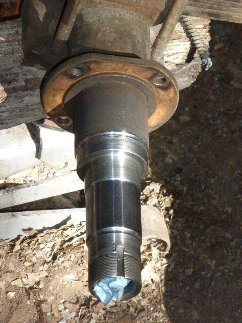

This is a test, to see if I can upload pics.. seems I can. this is stripped RR D70 (71?) on my truck. The flange with lighter colored rust is mounting surface for drum backing plate, or upright to support the caliper, if using disks.. More to come.
Why yes, I did torch off the ebrake cable..

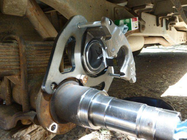

This is Great Lakes Offroad caliper adapter, with mounted '74 K-20 front caliper, $20-something down at Autozone. This adapter will also take the late'60s-early '70s Cad ElDorado caliper
(D-52,style, I think they call it). $70 something at AZ, but it has a parking brake. Cad pads are too thick for K-20 disk, so you have to attack Cad brake pads w/belt sander...
This is proper mounting position for this application, to keep bleed screw on top of caliper.

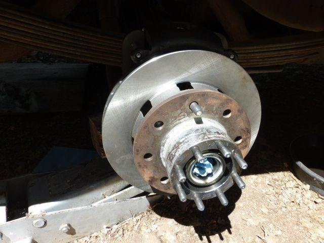

Here's the problem, if you can see it, sun's going away..
This is K-20 disk mounted to Dodge rear hub. Notice that the caliper, back there in the shade, is BEHIND the disk, not really what we were looking for.. The caliper is at the proper height, though.
Requires either about a 2" spacer behind caliper adapter, or about 2" adapter ring between disk and hub, but I doubt that there are wheel studs that long manufactured.
FYI, chev disk is 1/4" smaller dia. than Dodge front disk..
What a PITA. Shame I can't find a deeper hat...
