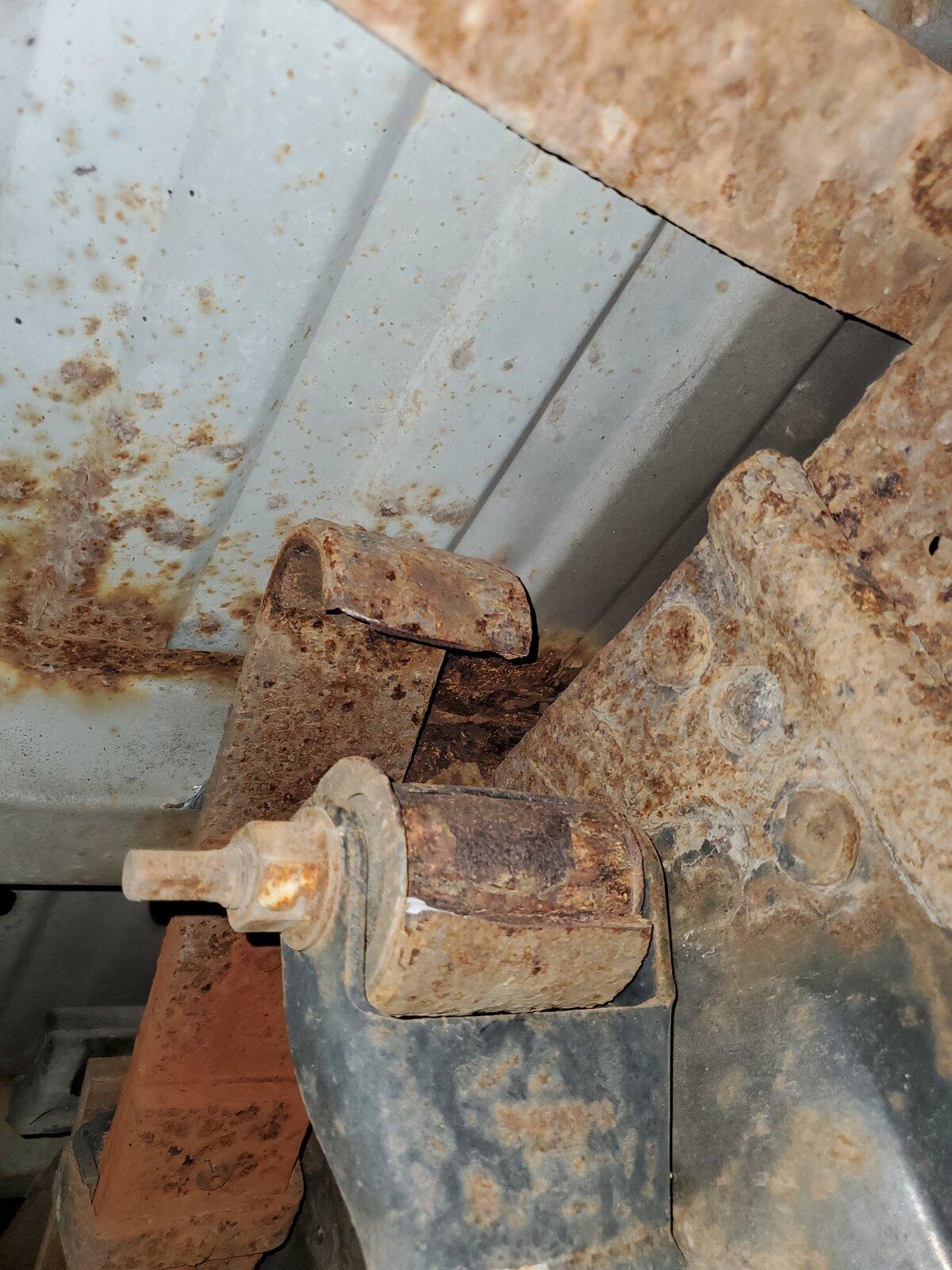

You may be lucky and be able to unscrew the nut off the bolt or if no go cut the head or the nut off. Problem I ran into was the bolt would spin inside the bushing and no amount of pounding could get it to come out. Ended up having to use a torch to essentially melt the bushing away well most of it. Then torch the bolt and sleeve. That happened on two of my bolts. Good luck probably going to be a chore as Ozy mentioned but doable with enough persuasion

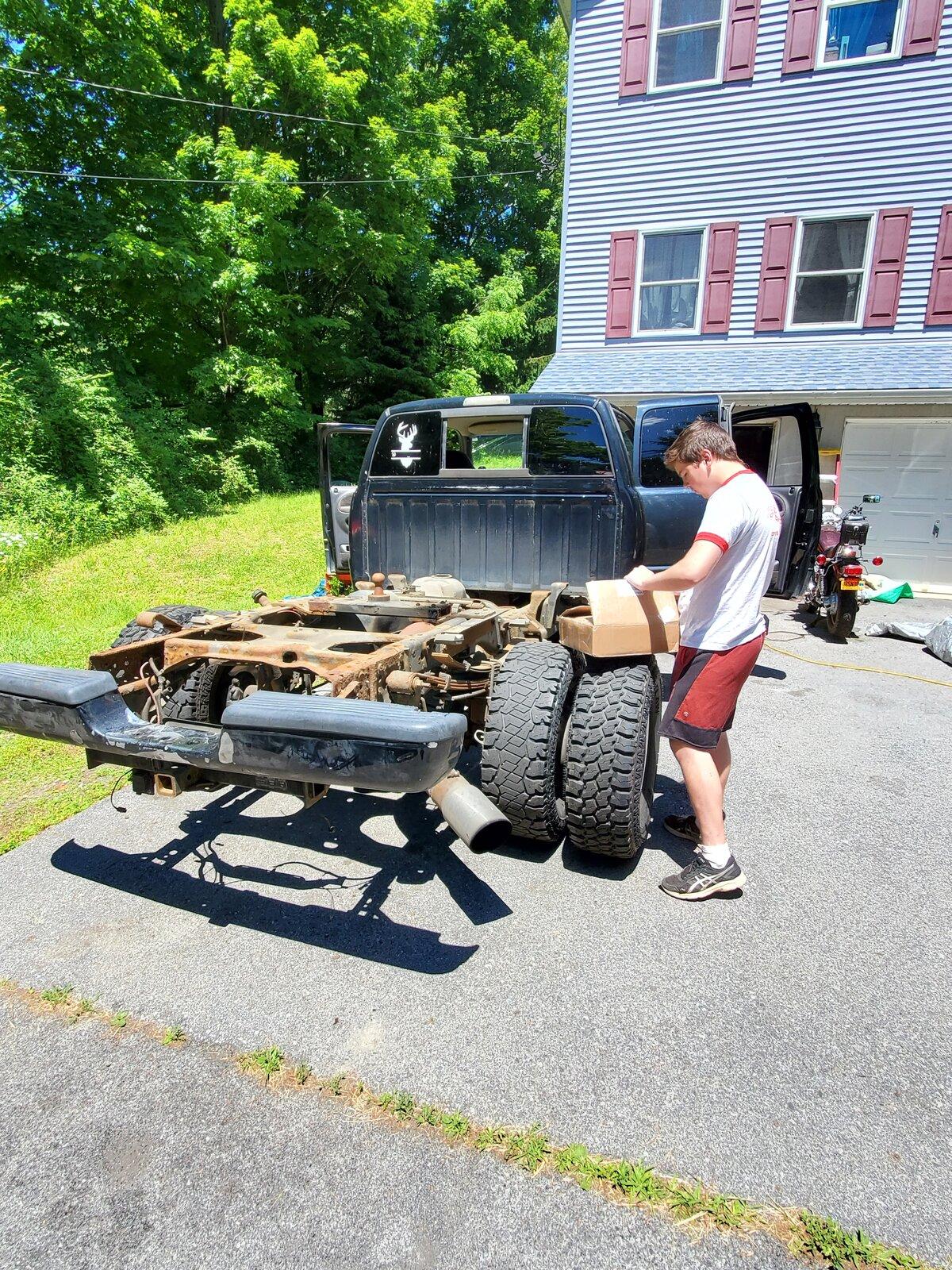

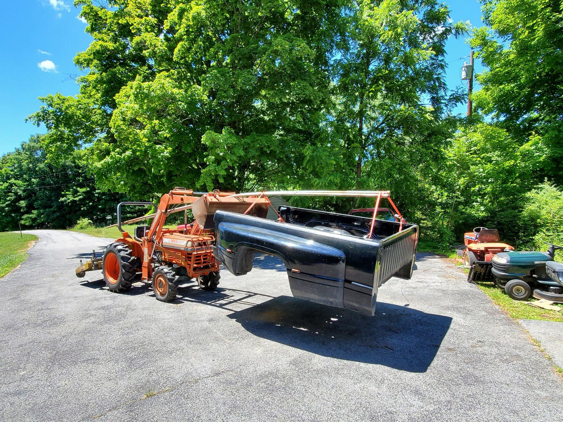

The first time I attempted rear spring bolts and shackles I wasted a day before I simply removed the body.
The next time I just removed the body first..
Makes it a whole lot easier...if you have any way to do so.
And while the body is off change the brake line that runs in behind the fuel tank...

The nut isn't the real problem - getting the bolt out of the spring bushing that is 3 inch wide rusted solid to the bolt makes the trouble.

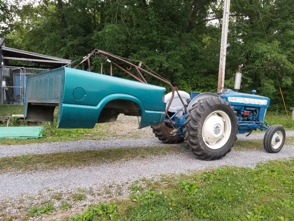

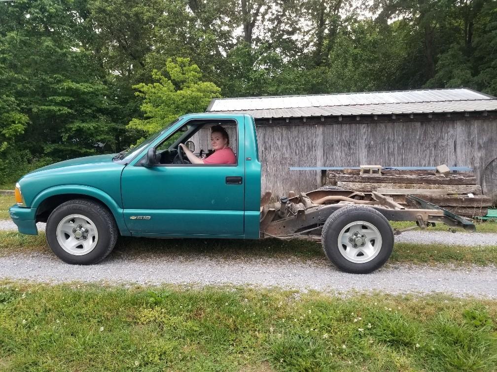

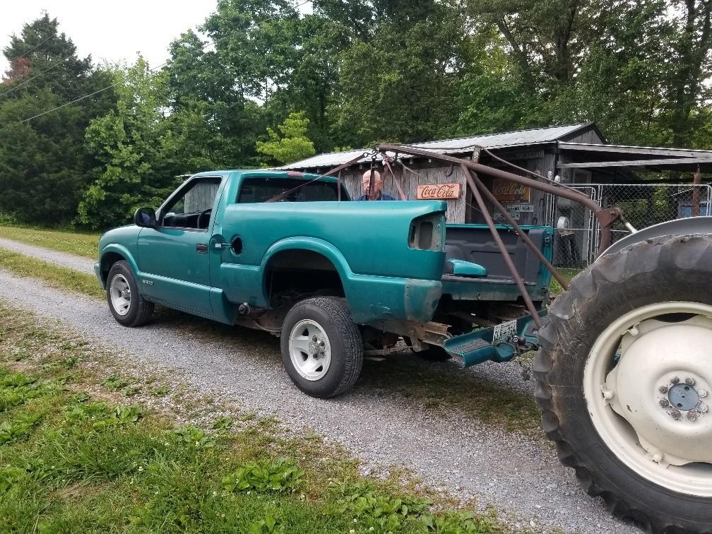

As Mike said, lift the bed. Makes things MUCH easier and it's not a big job. Pulled the bed off my daughters S10 last week to get to the top of the tank. I know it's not a Dodge dually, but it's basically the same job, just a bit bigger.

How many bolts hold the bed on?
I have a non rusted bed that has to go on anyway, so I guess its a good time. Colors don't match. But it came with the truck.

7 bolts, a couple wire connectors, fuel filler neck and tail lights . I think I had this ready to come off in less than an hour. Took longer to take my twin 102" whips and mounts off.
