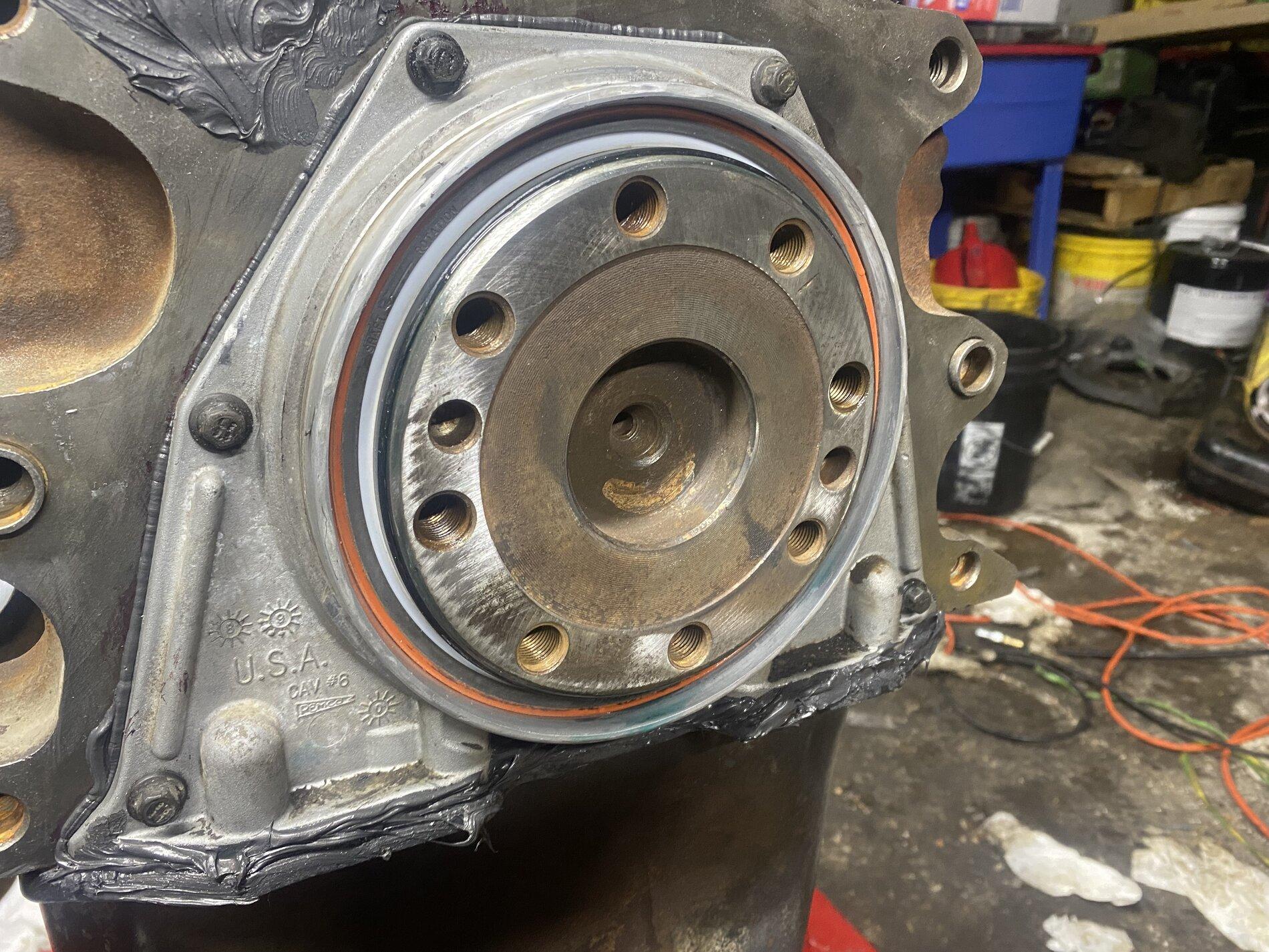

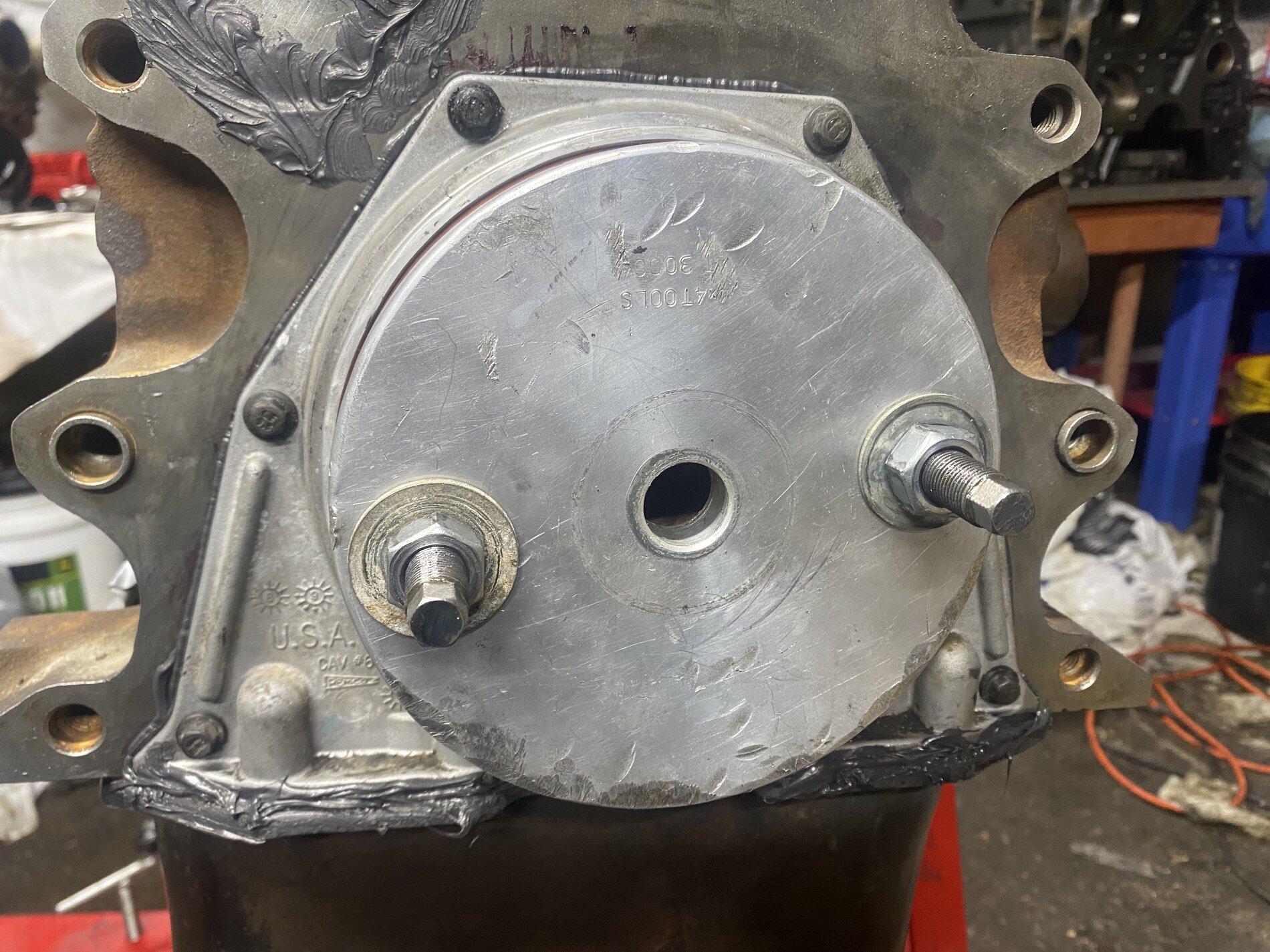

Any tips on getting this stupid wear sleeve and seal on without ruining it ? I have the quad 4x4 tool but it didn’t work worth a crap last time
Use a flex plate and three or four bolts to press it on. A pressure plate will work too but the weight makes it a bit more difficult. You might need to find some longer bolts to get started.
The very edge of the crankshaft had some raised spot I had to machine downs once I did that the seal tool pushed the seal and wear sleeve right on nicely
