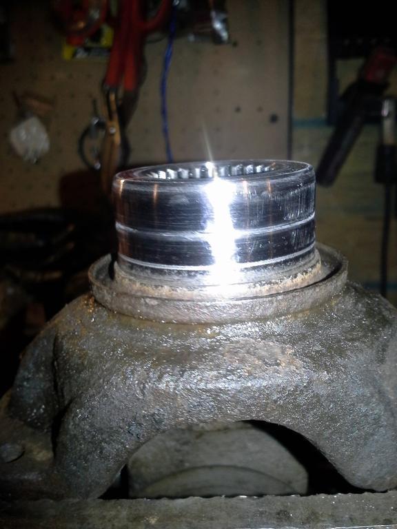

Since I'm a little fed up with throwing parts in my truck since the summer, I would like to have opinions about the rear pinion yoke. I'm changing the seal and it seems that the old seal has grooved the yoke. I've cleaned it and sanded it with #100 and #400 sand paper but I can clearly see the groove (see photo). Do you think I'll have a leak if I put this yoke ? Should I sand it a little more ?

I think you’ll have a problem for sure trying to get that to seal, a wear sleeve will do the trick and according to Bob are available from Dana. I did a quick check on Rock Auto and they appear to have them as well.
Thank you very much.
Your advices just confirm my thoughts that the truck will not run on monday...
I've checked at RockAuto and they have the sleeve. I'll have to check at the local store before and if not available, will have to buy online and wait again a couple of days. Planning is the main thing with an old truck and remote locations...
