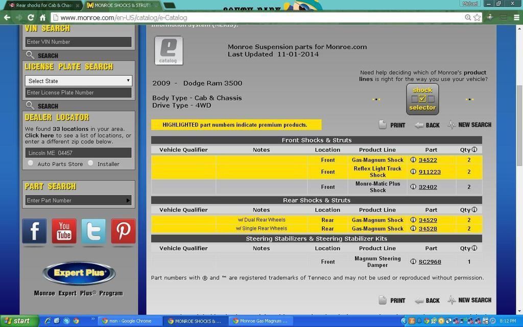

From the Monroe e-catalog....these are new..
This is perfect! Thanks guys for the recommendations. I really didn't want to put OEM shocks back on. On that thought though, I wonder why the bigger named aftermarket shock manufacturers haven't been producing shocks for these Cab & Chassis trucks... they've been out since '07! And there are a good number out there. I wonder if the Ford and GM/Chevy use for their shocks? Two different size bolts like Dodge? I'll say it.... that's just dumb.
