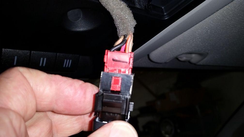

Window wires, power in the center, left and right movement related wires on either side.

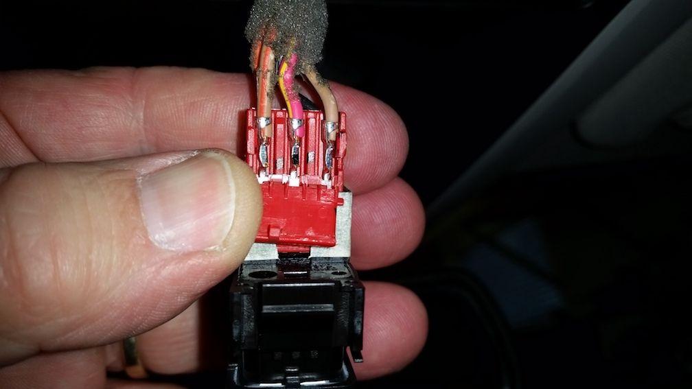

Ground and power wire for the internal LED to light up the switch when the headlights are on

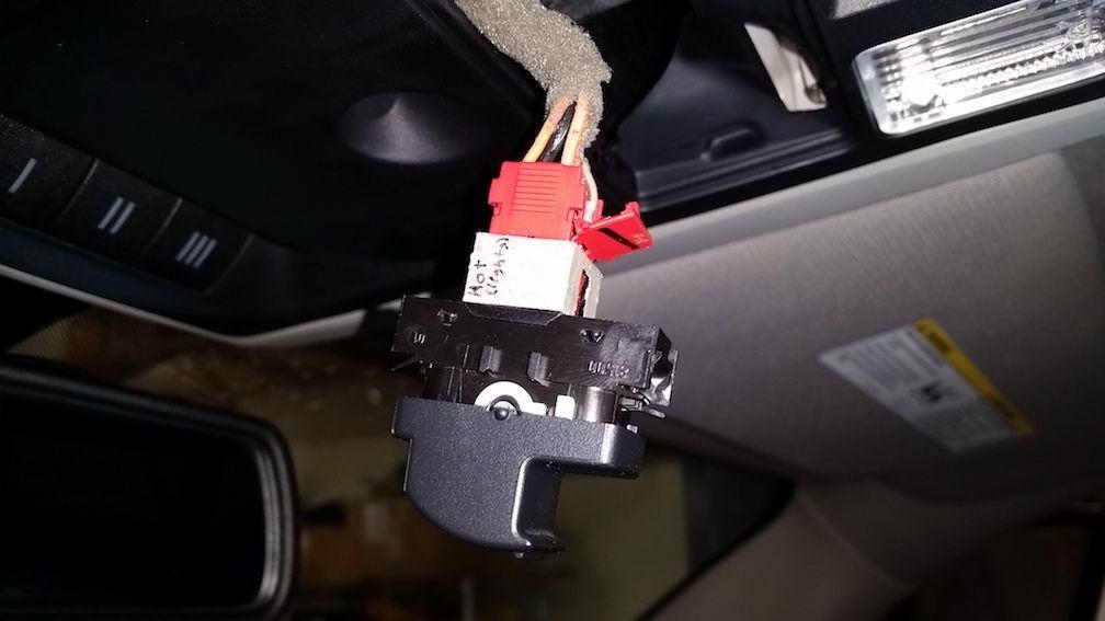

Switch with wiring harness plugged in but with switch out of its trim panel. I've used masking table wrapped around the socket on the switch so I could write what wire does what on the tape.
