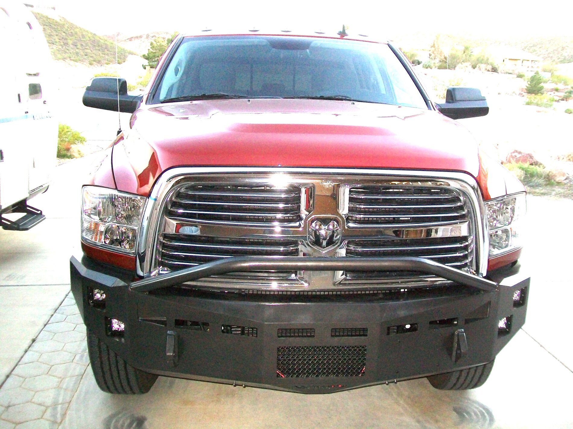

On my 01 I had a Denver Off Road bumper. It was aluminum 1/2 and 3/8 inch thick.. It took a 60mph hit of a deer center of bumper and suffered no damage at all (nor did the truck). Another aluminum one that comes to mind is Buckstop you can get theirs in aluminum and they have several different styles. On my 17 I had an ARB. While it was steel it was not crazy heavy maybe 150ish lbs. I really liked it though it was never put to the test of a deer strike but I think it would have held up pretty well.
I have a steel Buckstop bumper with a Warn 16,500 lb winch. Because of the additional weight I had a spring shop upgrade my coils. So keep that in mind.
We have the same Buckstop bumper/winch setup on a ranch truck which hit a mature Mule Deer buck at highway speed (probably 75 mph+) and it cut the deer in half with no damage to the bumper or truck. Same truck and bumper while my brother was driving it and some idiot on a 4 wheeler hit the truck coming around a blind corner at 45 mph. He hit the bumper which deflected the 4 wheeler into the driver front tire which tore off the wheel and spindle. No damage to the bumper or front of the truck. Years ago I had a 4WD Chevy 3/4 ton Surburban that hit a doe on I15 just before Cedar City and the deer's head could be seen imprinted in the grill. That hit took out the radiator and disabled the truck. I don't use my truck as a daily driver so not really worried about frontal impact accidents. I'm a fan of heavy duty bumbers!

Thank you for this information! The biggest driving factor of getting some sort of front end protection is to prevent my pickup from being disabled while towing our 5th wheel in the middle of nowhere. I will look into Buckstop as well.
