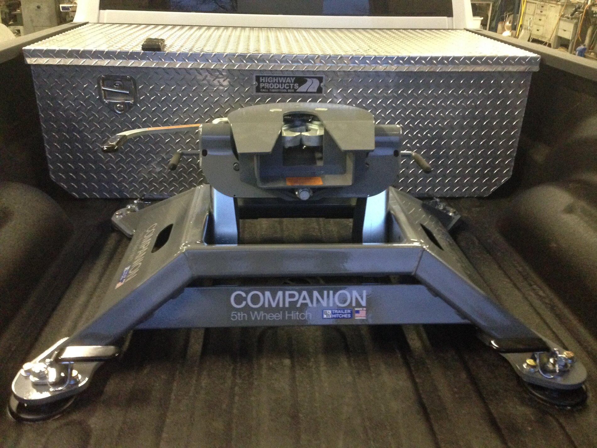

I never considered the vertical range when buying a puck system hitch, I knew the only hitch I wanted to run was the B&W Companion RVK3600 and I’ve been very happy with it. It has plenty of adjustment, especially when you take into account the 5th wheel also has vertical adjustment.
Thanks. I have read many good reviews of the RVK3600 and it is on my list. I don't expect to require towing capacity above 16k, so have also been looking at others. But it's good to know that the pin box can also be adjusted. I'm coming from the travel trailer world so this is new to me.
If you want top quality 100% US Made the B&W is the way to go. If you want simple solid construction and no question if you are properly hitched the B&W is the way to go.
Do NOT even consider the CURT or ANDERSEN.
The Highway Products tool box is top cabin also!

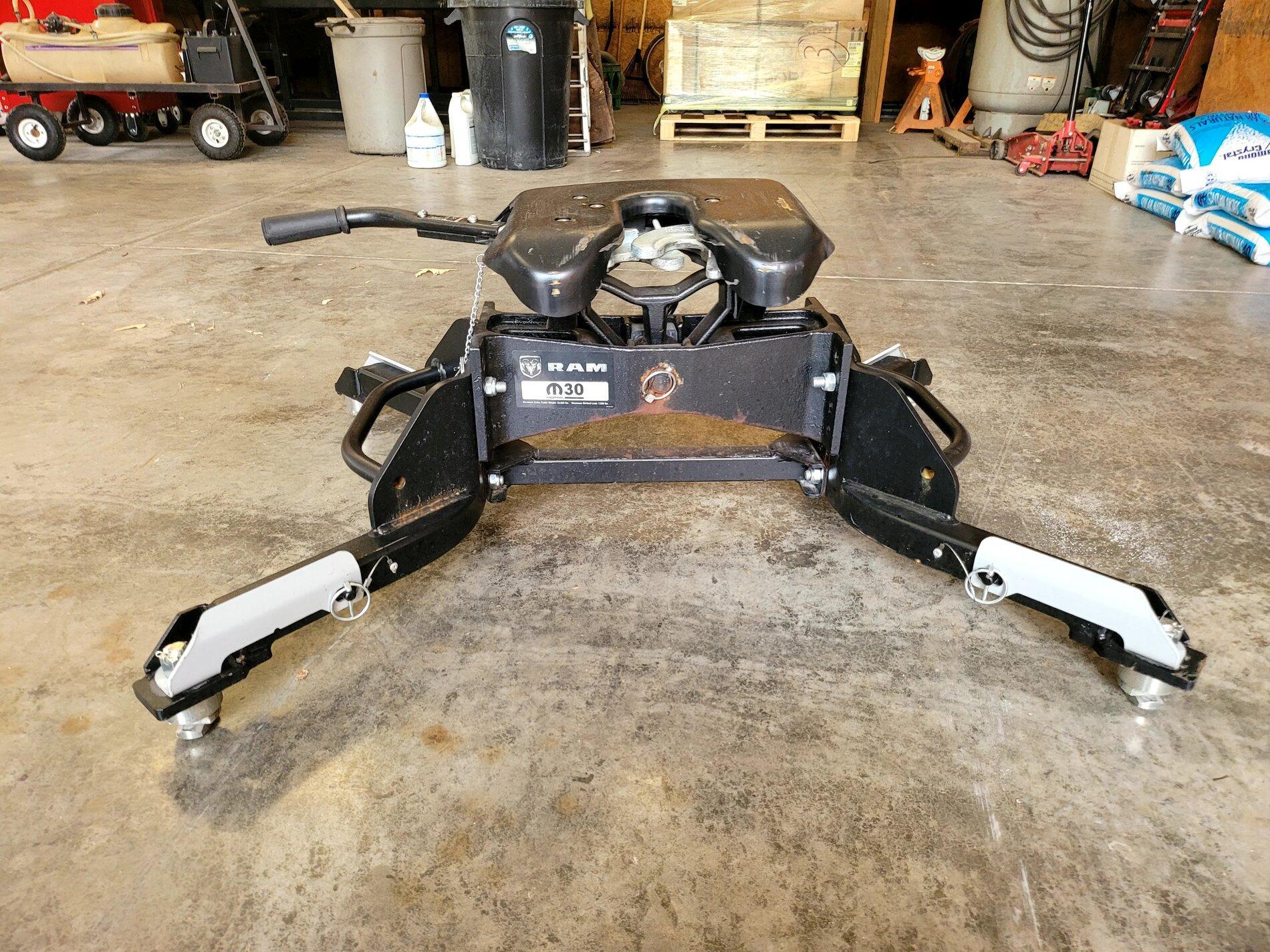

I have a Mopar 30K fifthwheel hitch I would let go for a good price, I used it 3 times in my 19. Traded for a 21 and got another hitch.
