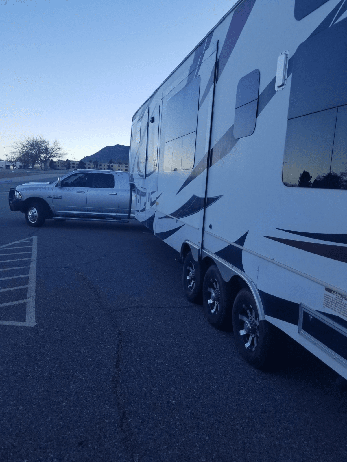

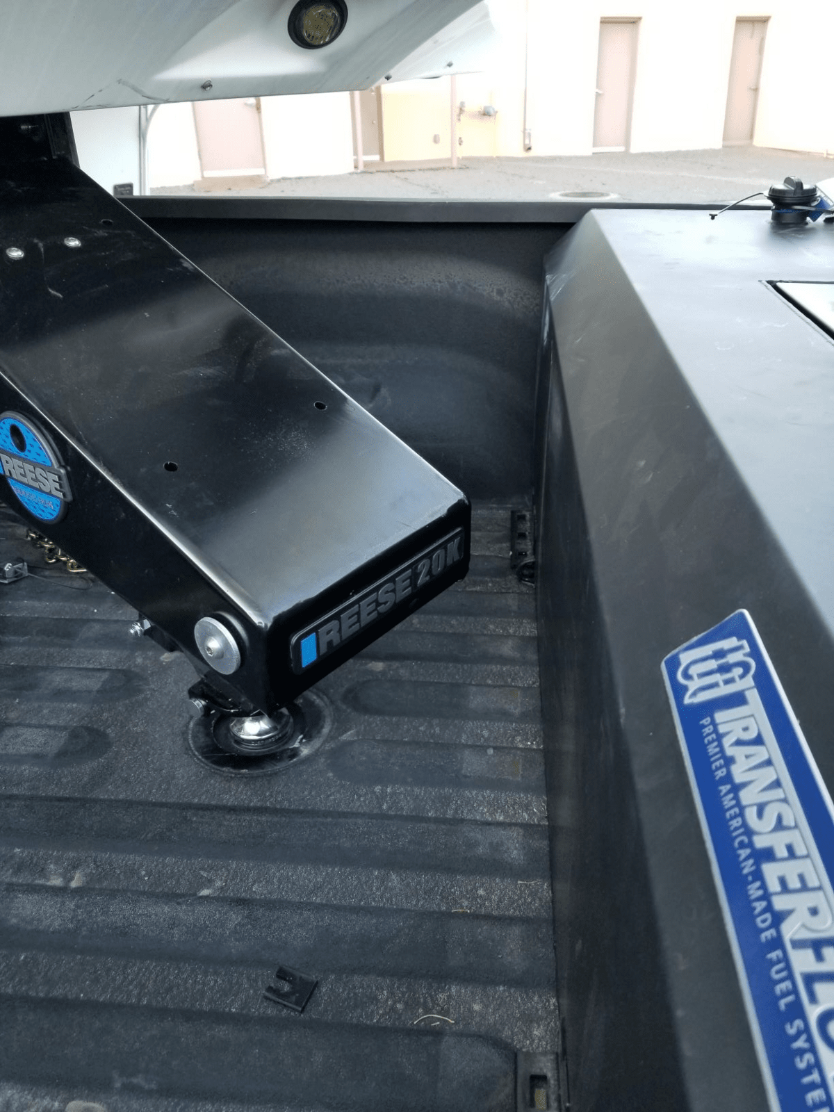

Got in the Goose Box for my Dutchmen Voltage. I had a Trail Air pin box which I had no issues with but I wanted to put the 75 gallon aux tank in and free up some weight and bed space by dumping the 5th wheel. The Goose Box is a heavy sucker, well about the same as the Trail Air was, but most of the weight felt like is was on one end.
My son and I got it swapped out with no problems. The gen2 Goose box is nice, has holes to mount the chains and another set to hang them when they arent being used. It rode very nice, no chucking and the airbag and shocks I dare say was better than the trail air. Most likely because of no chucking at all.

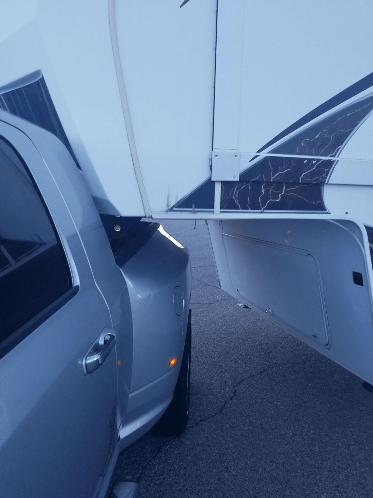

I snapped a couple pics, sorry they are a little dark but just snapped them while I was checking turn ability and clearance to the tank. I had pre measured everything but you never know until everything is in place!
As you can see, plenty of clearance between the Goose Box and the fuel tank, I have right at 6 inches of bed clearance which I may get a ball with extra height if I think its necessary later.
I can almost turn 90deg and this is obviously a Megacab short bed. In the pics I still had 3 inches of clearance but I was satisfied knowing I could turn as far as I did.
Theres a double picture but it wont let me remove it.

I didnt swap it just to fit the tank. I got the 75 gallon tank because i could fit it after the swap, not because of it. I have more bed room and I saved a few hundred pounds no matter how you look at it without that monstrosity in the bed of my truck.

I have a question since I have a Mega Cab also. In your photos you show the truck and trailer at max angle of turning correct? This is on a nice flat piece of black top a parking lot, correct? What was the distance between the "C" pillar (rear of cab) and the trailer, did you measure this distance? The reason I am asking is did you do this experiment with the trailer rotating the driver side corner up as the trailer rear axles on the passenger side are dropping due to an uneven campground road?
Being that I have nailed my cab once when I forgot to move my manual sliding hitch with an attached trailer that had 88DEG corners advertise for turning. This was due to a very tight campground road with a very uneven road surface, as I was pulling the unit and not even backing up. I have since switch to a DEMCO AUTO GLIDE Hitch which is great for my needs.
I am just saying everyone that I have had discussion with about the Reese Goose Pin Box have all said the same thing it is great and will not hit the cab when turning! But they have never shown me this maneuver when turning the truck and trailer on uneven surfaces how much clearance they have.

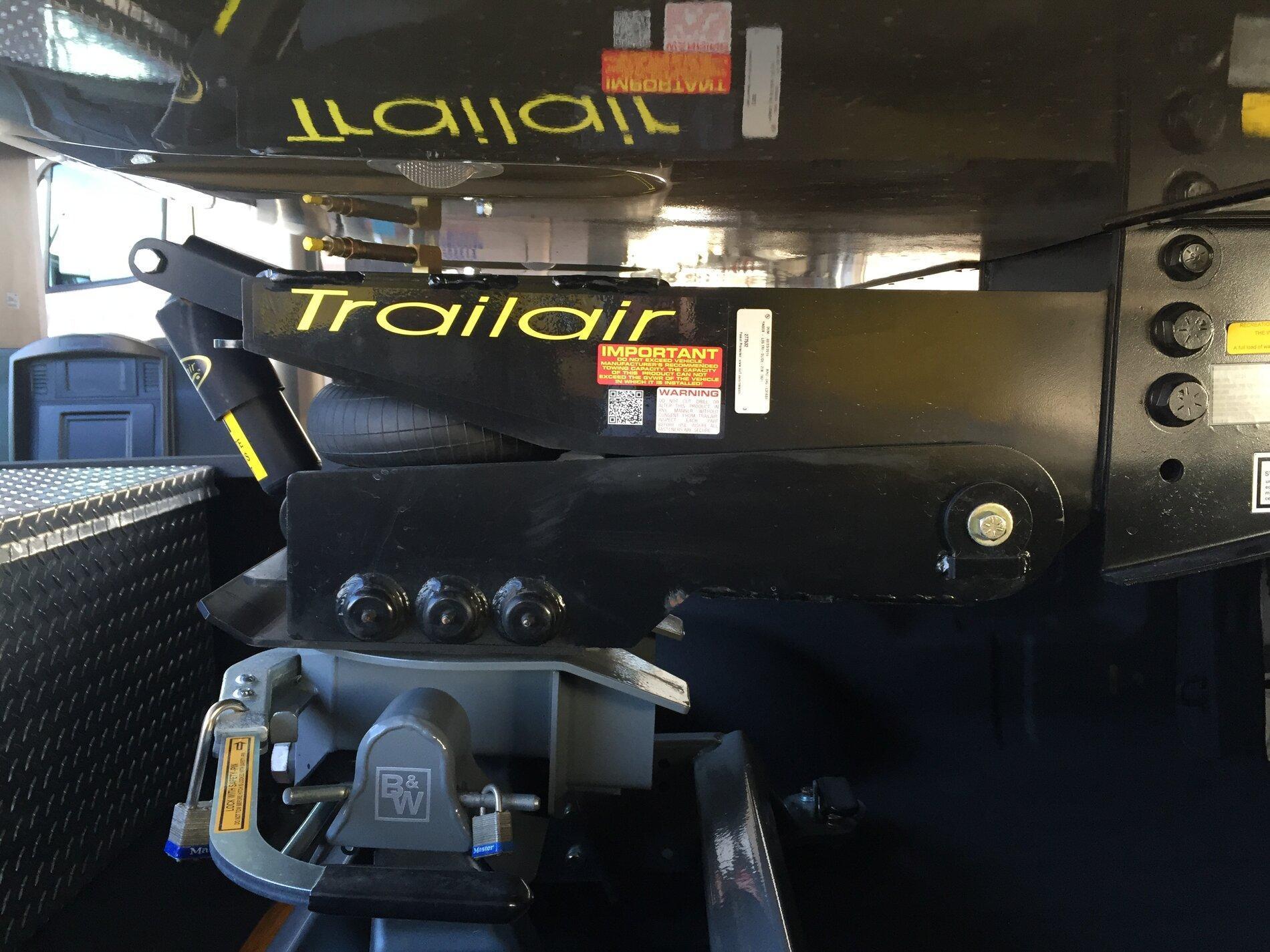

Pic below is good as it gets IMHO. Front to back absorption and up and down absorption. I would wager the "slop" in the gooseneck connection is no more or less than the Companion that is near nothing. The picture shown will not void the frame warranty as many gooseneck adapters will with the additional stress placed on the pin box frame support.
All of the pictures above were taken with the truck in the exact same spot. This was a parking lot but their was a slight grade to it, nothing like an off canter RV spot.
In the pic, there is about 3 inches between cab and trailer at the closest point. I was by myself so I didnt want to try and get any closer than that. The distance was greater as you go up so if you were backing up a slight grade it would not be an issue. It was good enough to know that I could get nearly 90 deg without a spotter if I needed to.
I was just thinking, there is a 4" extender for the GN ball that might give you a full 90' turning and give you some more clearance with the cab for backing hard into unlevel ground.
Cheers, Ron
A 4 inch extension would cure any turning concerns, however I have not seen any extension that is made for the factory hitch. Not one. I have looked and if anyone comes across one please let me know. Right now I would have to replace the factory hitch with a B&W which I wouldnt mind doing, I just can not justify the cost for the benefit at the moment.
